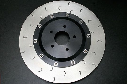

One option would be to switch to a floating rotor design with the "bobbin" or "McLaren" springs. This will aide in radial and axial expansion under heavy load or performance race braking. This will also extend the longevity of the rotor and brake package.
I don't think anyone makes a direct kit, but with a few simple tweaks I'm sure there is a manufacturer out there that has a rotor which would only require machining a hat.
Anyone have the rotor spec dimensions or the F-types? I know the R's are a 380mm rotor, what is the thickness? What is the base dim rotors?
