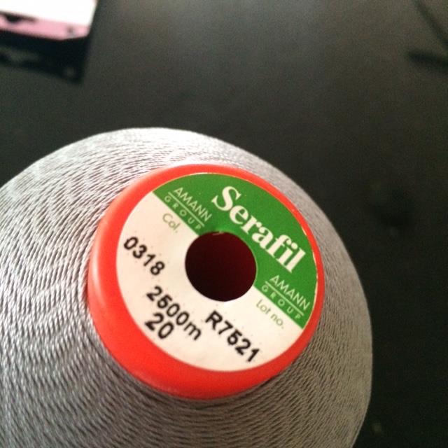

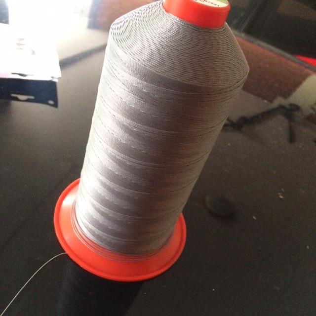

Went down to a sewing wholesaler as none of these types of threads are found in our local shopping centres.
One thing is always great when you meet someone at the desk that is into their cars I find they will go above and beyond to help out.
After pulling the colour chart out we came up with a few different browns and a also a couple different types of ivory not to mention the silver/metal grey.
I found the browns looked very good on the doortrims but didn't suit the dash probably because of the silver panelling as opposed to the ivories were the opposite way around however the silver suited the lot doortrims, dash, seats etc

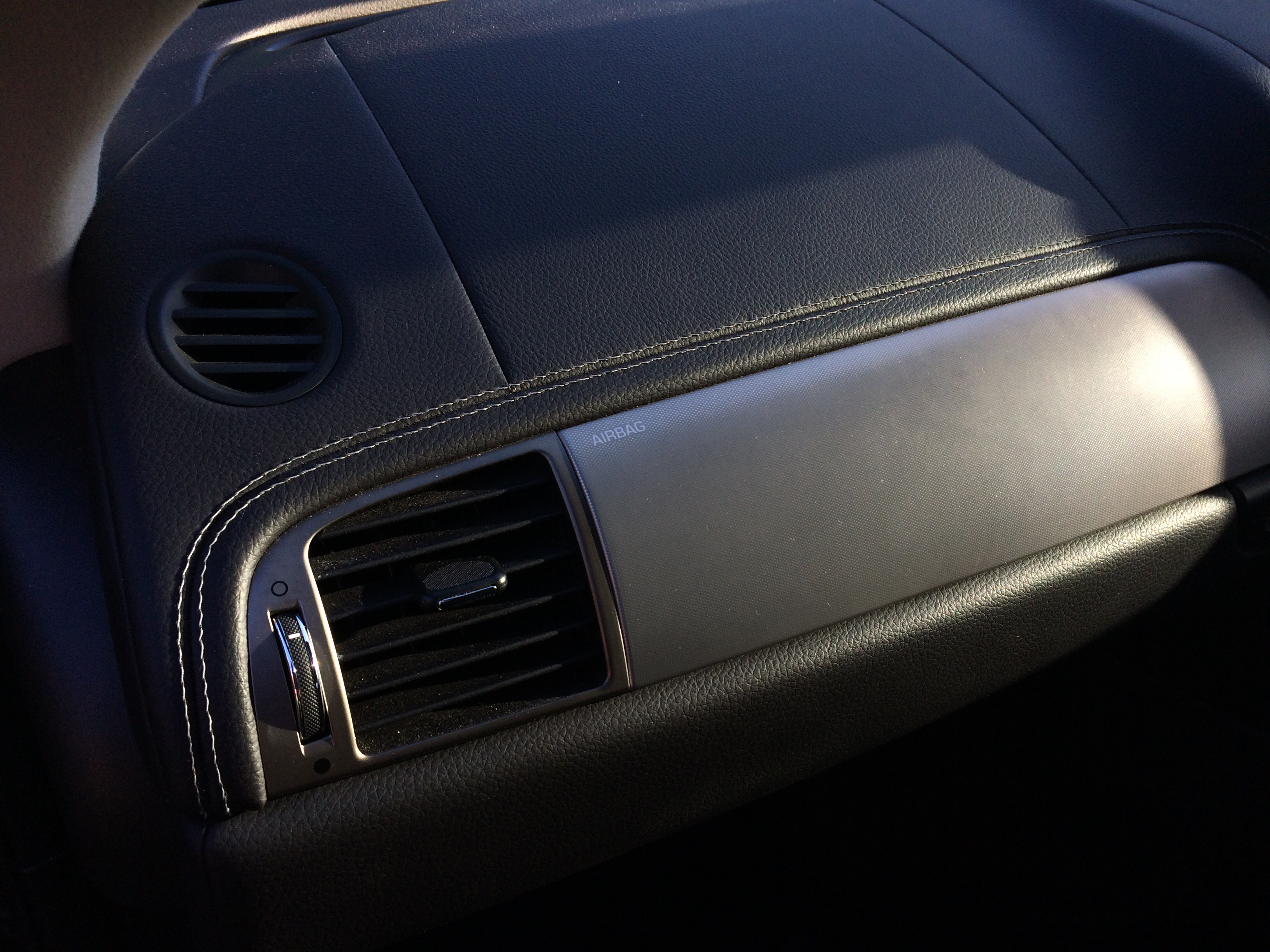

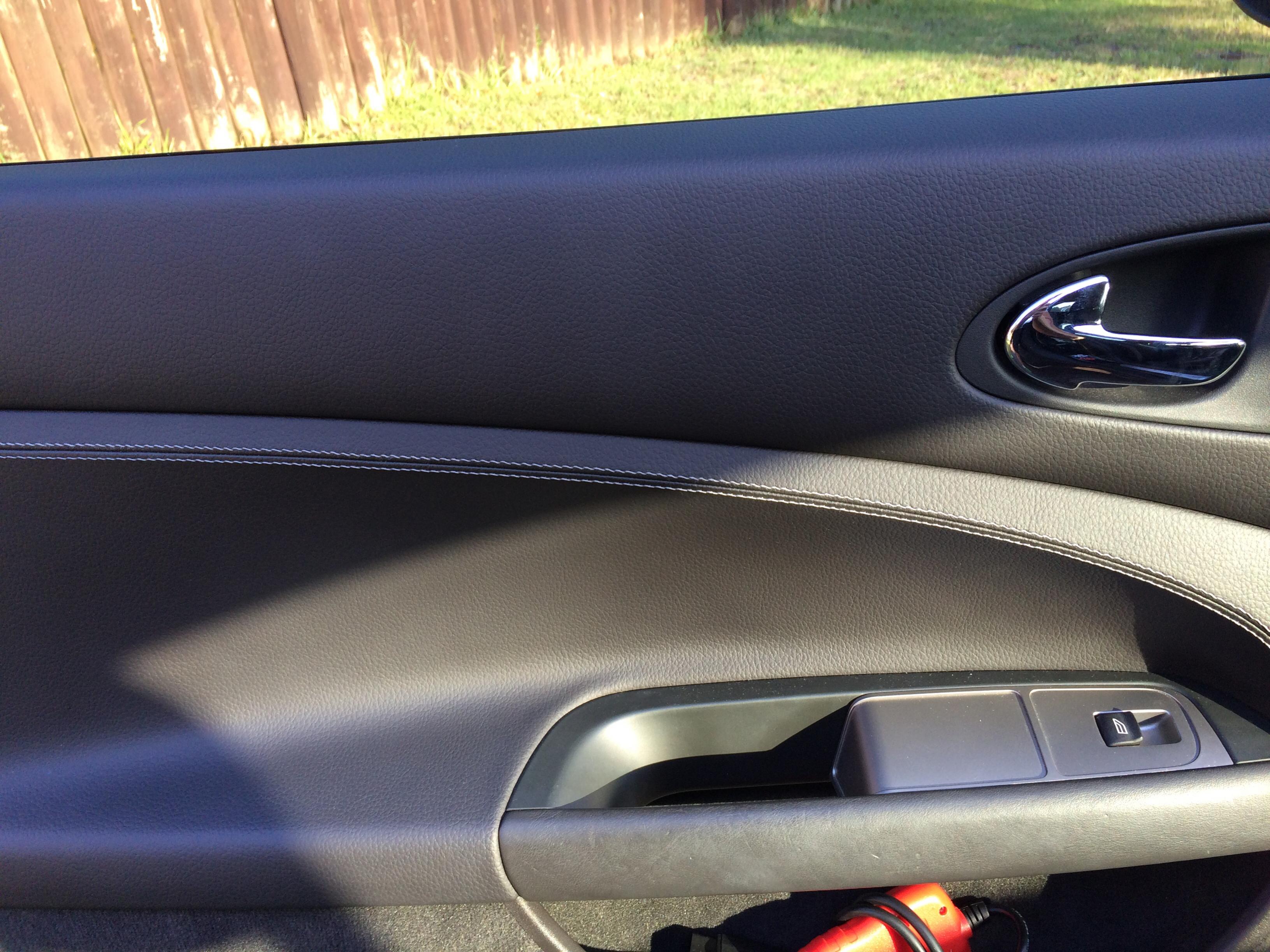

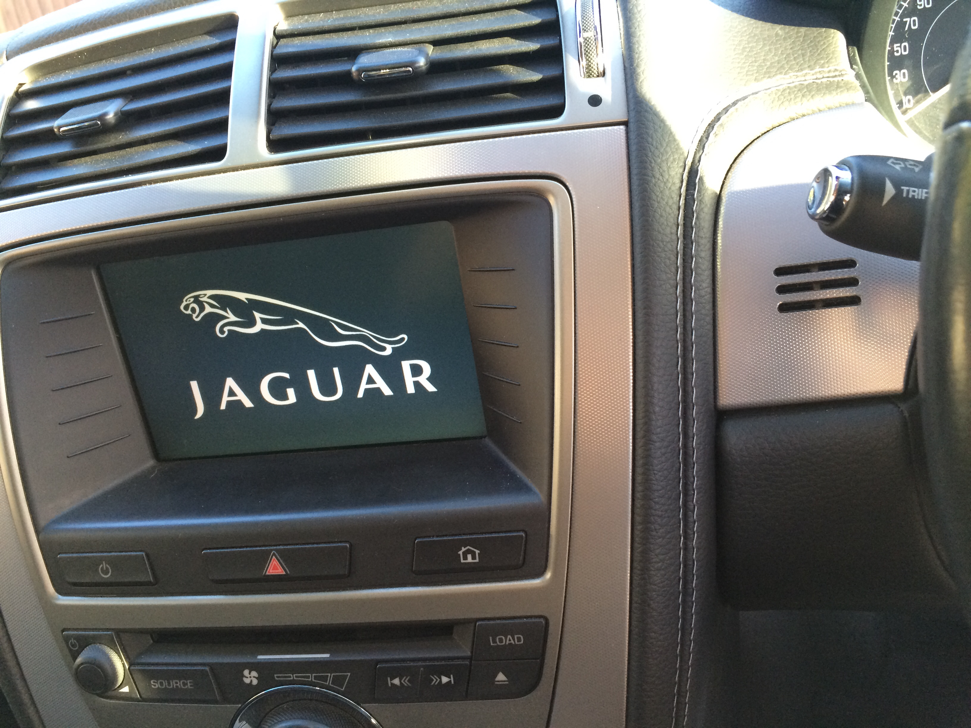

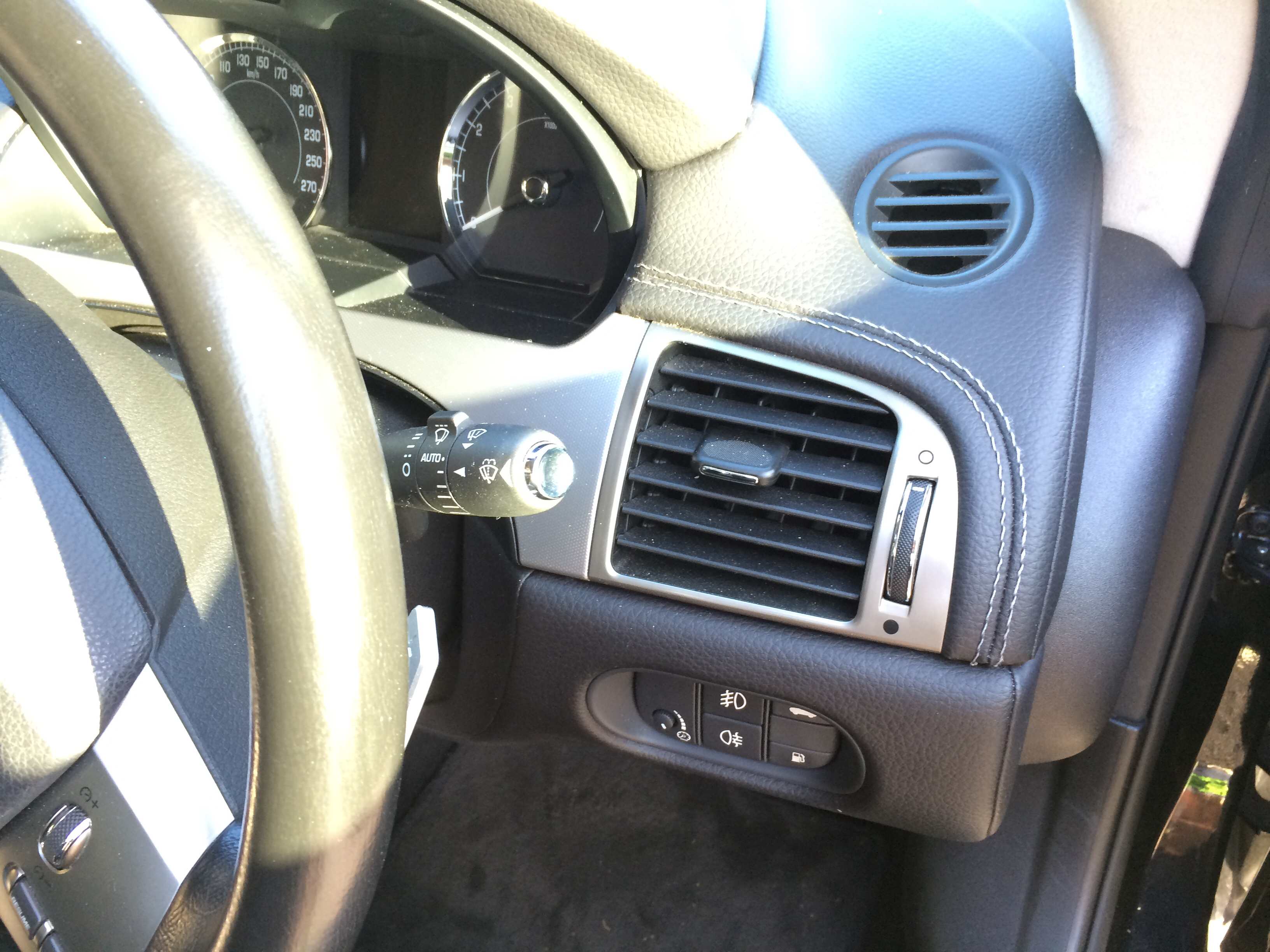

That's it for me Leeper I'm done !
Attached Thumbnails Contrast stitching DIY-photo179.jpg   Contrast stitching DIY-photo652.jpg   Contrast stitching DIY-photo82.jpg   Contrast stitching DIY-photo379.jpg   Contrast stitching DIY-photo885.jpg
