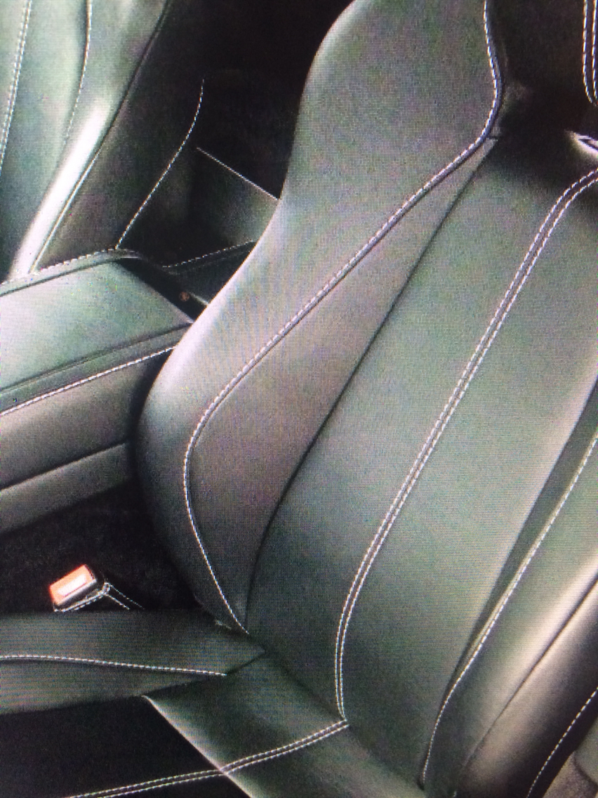

I think the touring pack would look unreal with stitching down the middle. The Aston do it and it looks fantastic

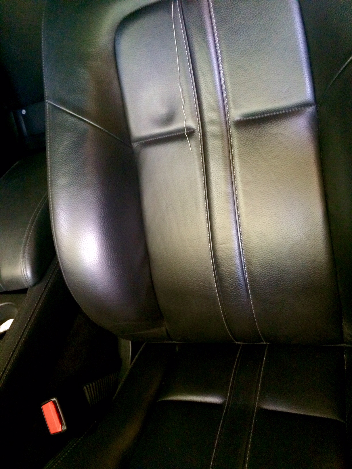

Center console goes pretty quickly, all said probably got @3 hours in that to complete. Here's a pic of the drivers headrest completed also a pic of the driver seat started, though not as tough as thought it may be it is VERY time consuming to do.
So far here's what I found:
Door panels were very easy/quick. Dash the same. Headrest were a little tough due to the leather being much softer and the odd contortions I had to get into to to do it. Seats will take more than all the other stuff combined! This will be no picnic but the stitching itself isn't too bad maybe because I am using a smaller, more curved needle for them don't know? I'll try to tackle one single line of stitching per day I think there's 32 if I counted right, maybe it'll get easier as I go

Powerhouse - I saw that too, got excited, even purchased the marker pen to do it, then realized it only works when you have white stitching to dye.
hHre's a pic of drivers seat before then a pic of the passenger seat bottom being done.

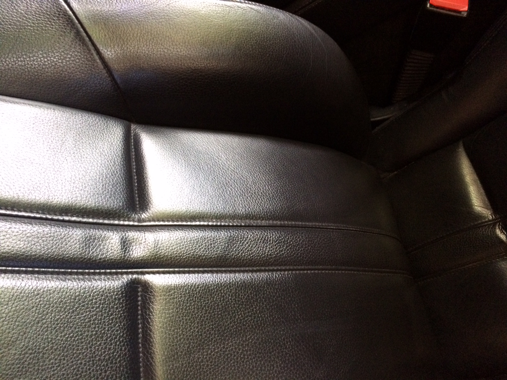

Default The subtle stitch
before and after use m20 / tex 135 size thread
Not as prominent as the thicker thread Leeper is using

Could be worse I just de-stitched 4hrs of work as I realised the thread wasn't thick enough on my seats it simply blended in
