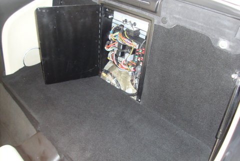

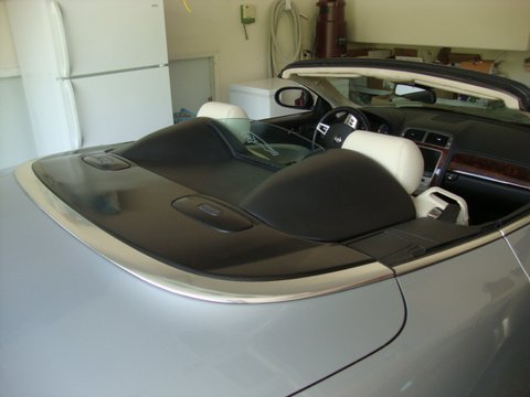

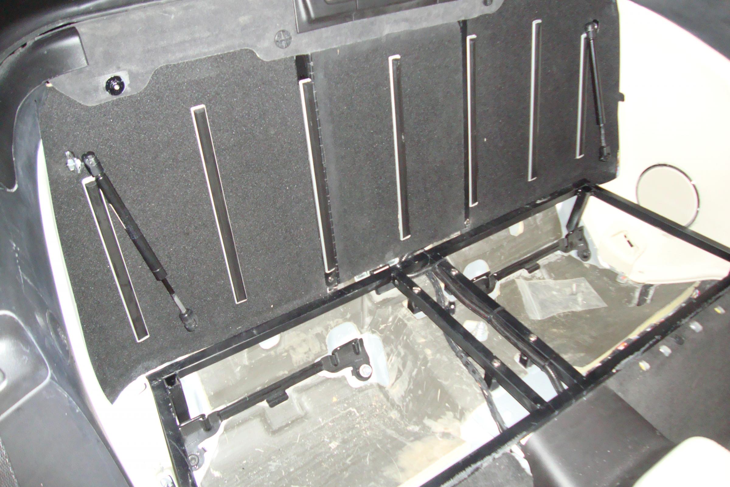

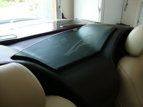

Here are some photos of my rear seat design. I gave this to chris at mina for develepment ,I beleive he his working on it at this time ' I will give him a call and see how he is coming along, you can give him a call also. You could just install the cover without removing the seat but it sure helps with storage. the rear window is glass and sure works well'
Chris is making one for me in carbon / fiber mine is covered in leather. Bernie

As I recall, Bernie (forum name Sherbercars) has already done a beautiful custom rear seat delete with double headrest tonneau cover. Looks like it came from the factory. Try searching this forum to find his posts including photos of the work in progress. Reply from my smartphone so I'm unable to do the search and post the link.

Spoke with Chris at Mina. He infoms me they are working on the cover at this time and should have a prototype finished in a matter of weeks. they have the New style c/fiber rear defuser finished now and should have the the front defuser finished in aprox two weeks.
Regarding the seats and seat belts , I removed the bottom seat belts compleatly , and left the top parts of the belts rolled up hidden behind the back panel. no problem with any lights , bells or whisels. Hope this helps if you have any more Q. I will try to help . Bernie

As I have posted above. I designed , built and installed it myself , and passed it on to Chris at Mina gallerys to develop and and make available to all Jaguar owners.
If there are any specific Q. please ask. Bernie.

I view it as better defined usable space. I picked up additional storage beneath the previous seats as there ia a "bunch" of wasted space under them. I have easier access to the fuse panel too. Most of all, it made for a better safer area for our two Yorkshire Terriers and their seat belts.
I was able to accomplish all of this without drilling any holes are mutilating any existing structures our upholstery. Easily reversible.
