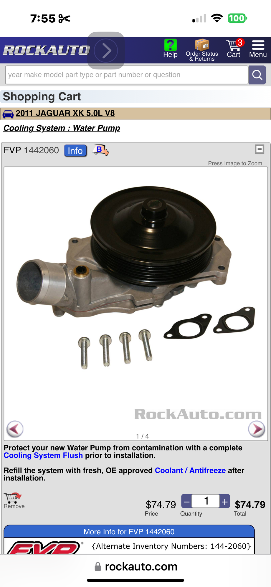

This is the water pump I need, but there is some kind of tube, this connects with and others have had leaks after replacing as you need to replace this other piece as well but I can’t figure what they are talking about?.. I’m in the process of purchasing parts.

I actually purchased a GEBA water pump as I was told by a highly reputable euro technician that Gates may fail... also GEBA has a cast iron impeller opposed to most being plastic!!!.. I also ordered an aluminum oil cooler pipe that goes on the back of the water pump pict. One... I purchased a brass elbow port for the Radiator outlet hose.. As you can see that plastic elbow is noted for breaking off after years off service.. I'm thinking of using JB Weld cement to affix the elbow to the water pump so no leakage can occur, and then a worm clamp on the rubber hose lead that fits to the middle of the radiator outlet hose.
i have one question?.. The garage charged me 177.00 just to tell me I had to replace the water pump without using dye.. There's only 2 torx screws and 2 washer nuts holding the bottom engine cover on.. So how can I be charged for a dye charge when no dye was used??? I know the service advisor works on commission because he was in a great mood after I handed over my Debit card!!!.. I'm sick of being ripped off!!.. And this is the same dealership FORD that basically takes care of my XK as Trevor is a good mechanic.

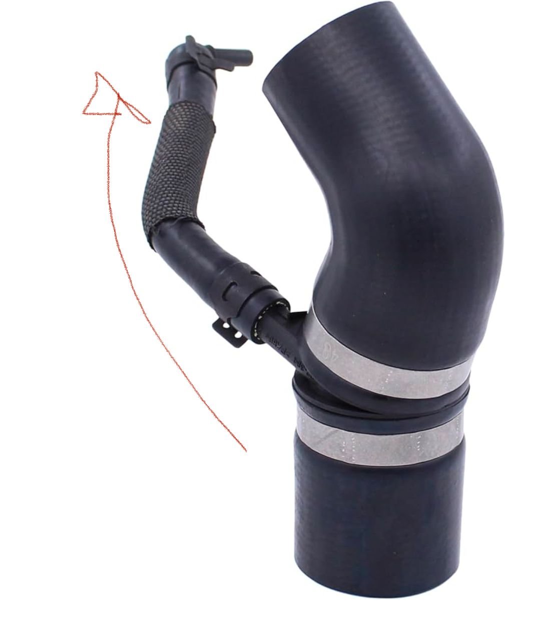

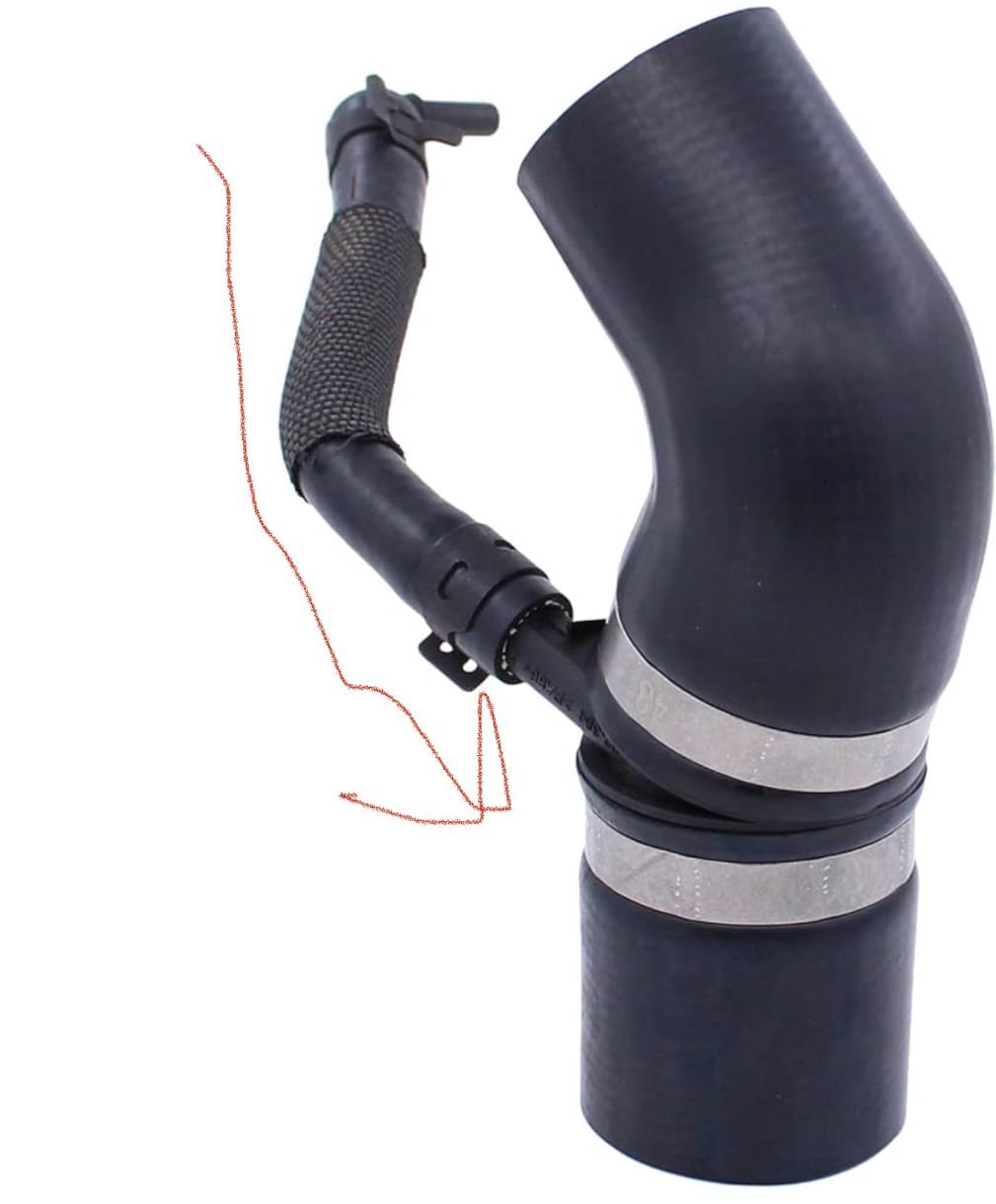

Default Direction flow of fluids
Can anyone tell me the direction of flow that runs through the thermostat pipe run off to the water pump?
would it be the first or second picture?

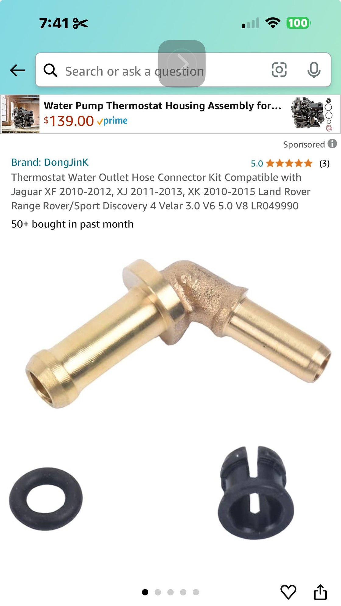

I have the upgraded oil cooler pipe with 2 o-rings that will be fitted between the water pump and oil cooler housing pipe in the Manifold...
my question for the coolant flow was for the brass elbow that is fitted into the water pump from the thermostat pipe.. My concern is if the coolant flows downward into the water pump then the brass elbow would be sufficient- but if the coolant runs upward towards the thermostat pipe I feel the pressure will push the brass elbow out of the water pump hole as some people say they still get leaks with the brass elbow.. The plastic elbow seems a tighter fitment... I just want to update that plastic piece as it's prone to deterioration with the brass elbow.
I also ordered a new manifold gasket and the Coolant Outlet Flange as they say becomes brittle over time..

Your right about that brass fitting? But the pressure is the same everywhere in the cooling system so if it's going to leak it will!
Several reports of the plastic collar and/or O-ring not being tight enough to hold the metal nipple in. So do watch out for that. Sometimes you need to mix and match what parts you have to get the best fit.
Yes I would use the plastic version if the brass one does not fit. This seems to be hit or miss too.
Yes sorry I forgot you have the NA 5.0L and that does not have all these parts out yet. There is hope as we have heard a vendor or two was considering it.
Hope your repairs go well.
What is your opinion on using JB Weld on the brass elbow fitted to the water pump?.. I purchased a GEBA as it was recommended by a Jaguar Technician here in Madison WI. He said they are far more superior as the impeller is a single molded piece, not spot welded metal.. I can't believe that some water pumps like gates using plastic for the impeller... I'm hoping that there is a resolve to the front crossover flange being made from aluminum for N.A. 5.0L's... I guess I'll just stick to the plastic elbow, my car is a 2011 so 14 years with 105,000 miles and no issues until now is pretty good.. I'm almost positive that it's either the crossover failing and filling the valley then leaking out, or the oil cooler pipe?... Regardless I'm switching the water pump out for safe measure. I'm also replacing the oil cooler pipe with aluminum and using 2 o-rings for the replacement...
