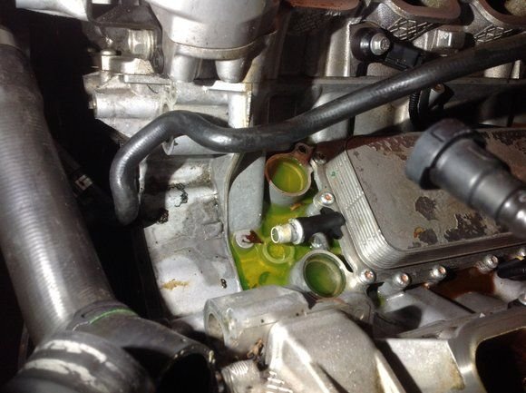

Greetings everyone,
I'm wondering if I have to place the o-ring over the spout from the oil cooler mounted to the valley inside the manifold because I tried putting the (2) O-ring inside the Oil Cooler Pipe wide mouth end and it’s not a proper fit as it looks warped (too big) inside the pipe… I have 2 o-rings, the other ring fits perfectly in the portion that fits into the back of the WP…

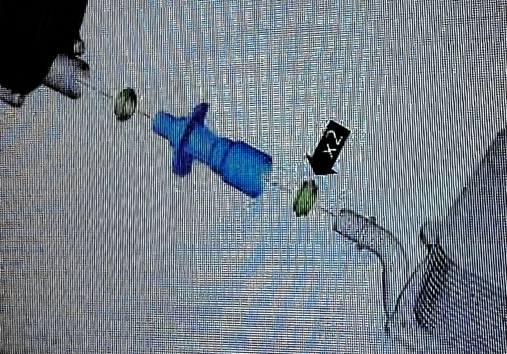

Where it says X2 that seal goes over the tube coming from the cooler. Your Aluminum tube slides over that seal. You should also see another piece of plastic behind that and make sure it's in the proper position too.
I think this picture shows it pretty good.
yes this is exactly what I was referring too... My concern is that I think the oil cooler tube butts up against that o-ring opposed to the ring sealing inside.
