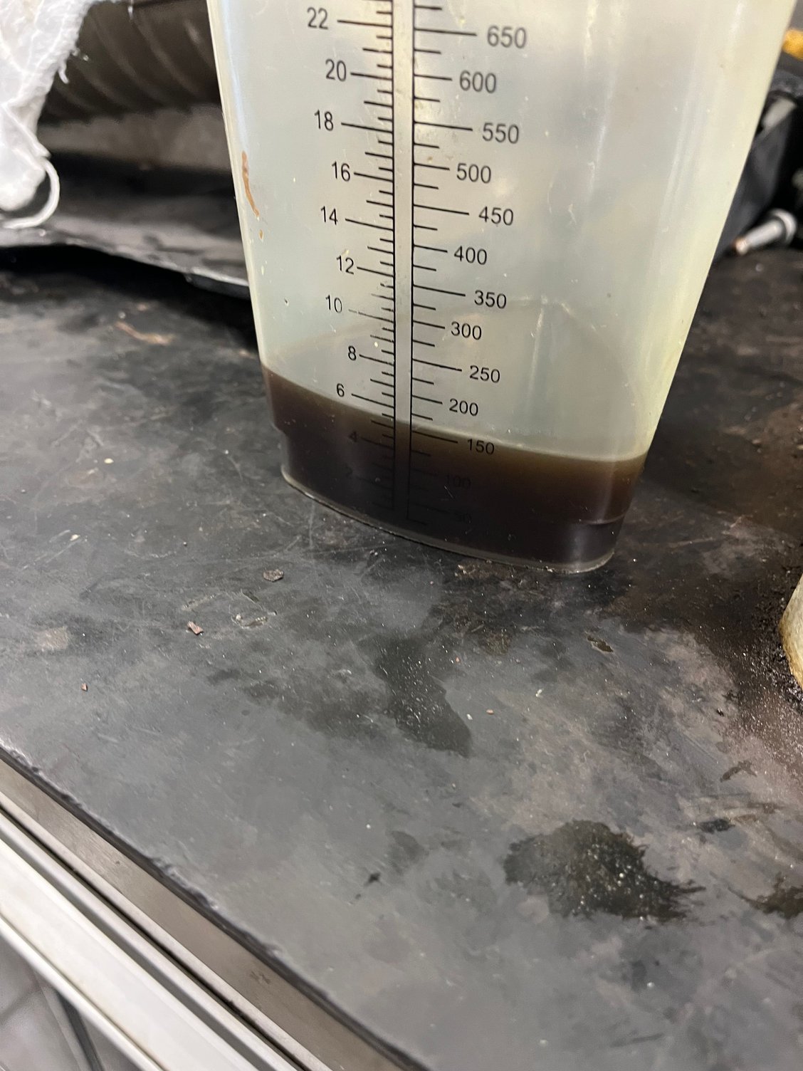

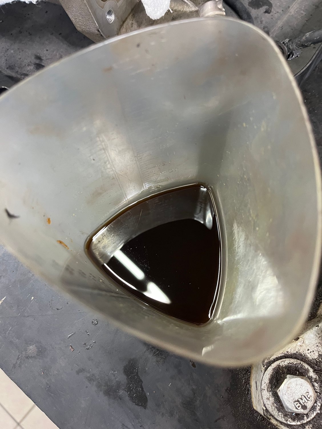

2007 XKR SUPERCHARGER OIL AT 53k miles, it stinks as well, glad to have it changed.
