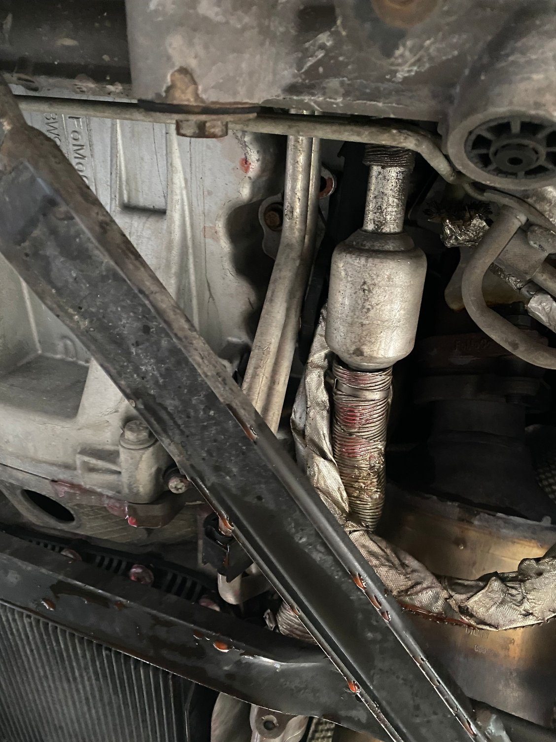

Default Leaking Coolant pretty bad
Jaguar friends,
I just saw this post and had to reply as I just towed my 2010 XK back to NC from Northern Virginia.
I am losing a good bit of coolant even on short drives. Car runs fine and no overheating messages or limp mode being triggered.
Any thoughts from the pics or video?

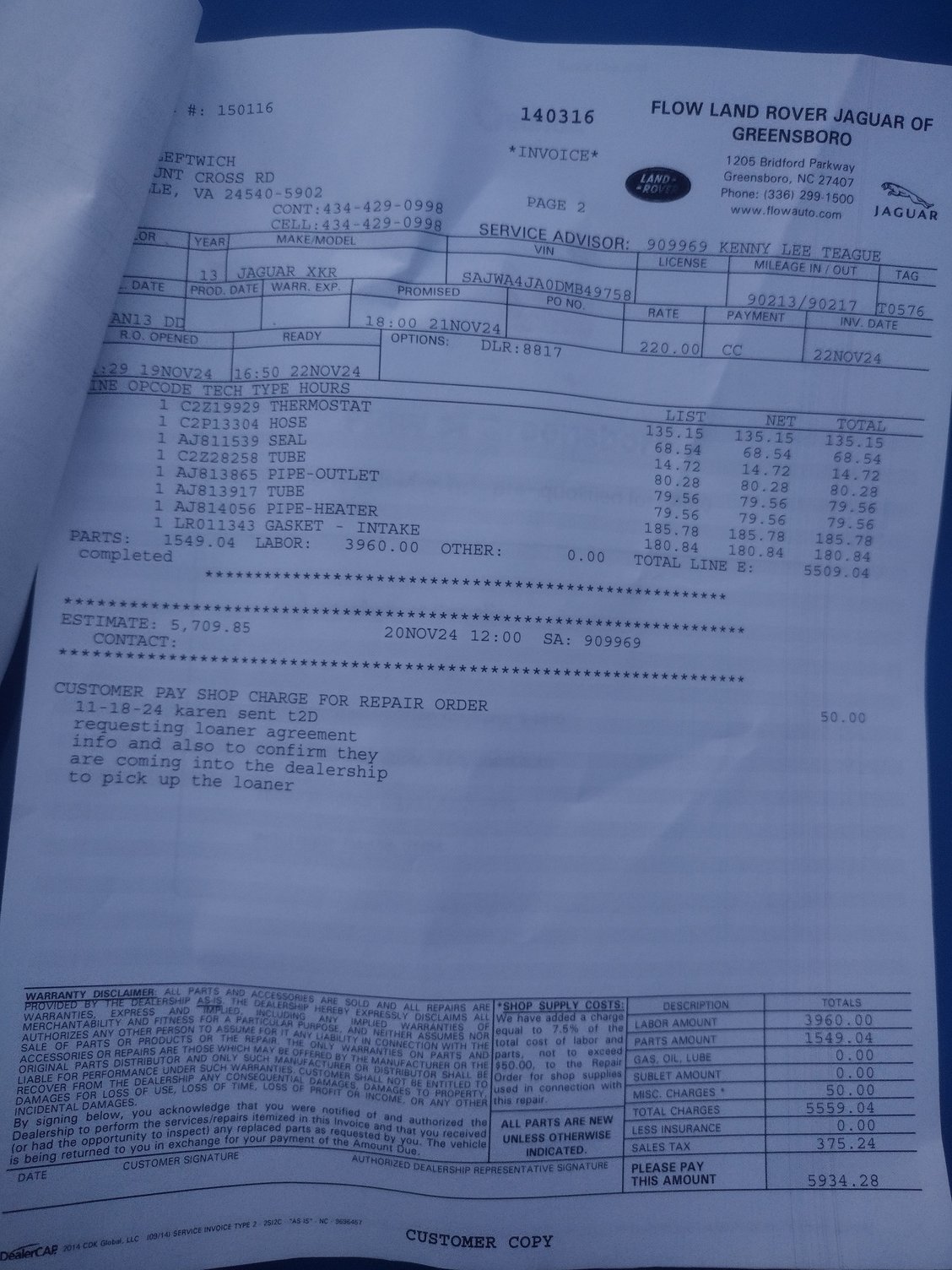

Just had all the coolant pipes replaced on my XKR-S.Come to find out it's a coolant pipe inside the engine near the water pump that busted on mine no matter how many pipes i took off to try to fix it.Even though fixing all the other pipes is good,if it's still leaking,You're going to either need to let a good Jag specialized shop open the engine to get to it or take it to the dealership for service.You gone have to let the pros do it unless you're 1 yourself if you really don't want to break nothing.Seems like this also not my 1st time here about this since i traded my old 2013 XKR for this 2013 XKR-S
