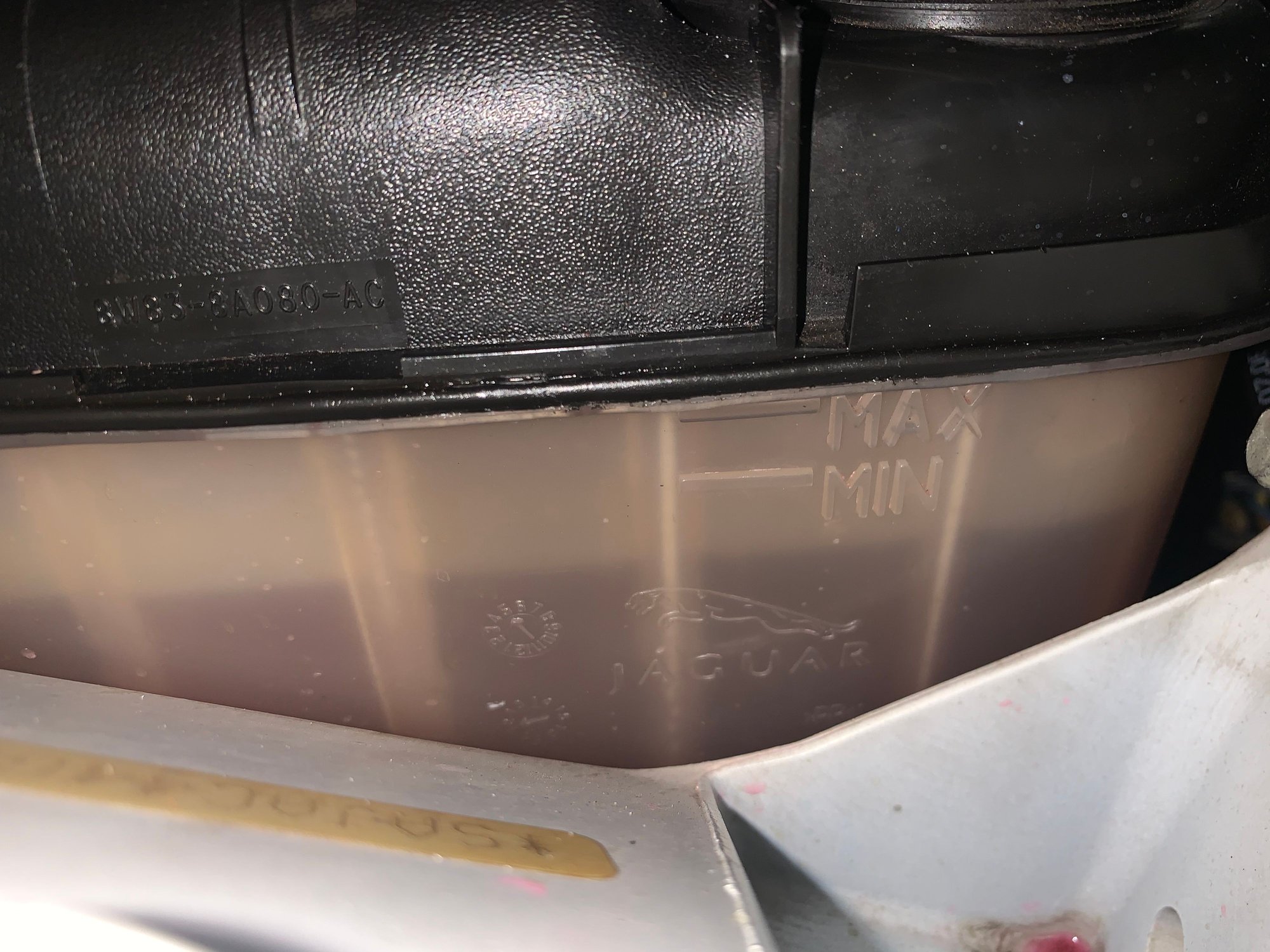

So it just got weird again. When the warning light came on and I nursed it to the shop they said hardly any fluid was missing. So I just drove home from the shop (about 20 mins urban driving) and no warning light but just checked under the hood and the fluid has dropped a significant amount! I can see the exposed plastic parts inside the expansion tank now! See pics

Seems to be airlocks, faulty pressure caps and leaking fluid season.
Have you read the Engine Cooling section of the workshop manual:
"The expansion tank provides the following functions: Service fill.
 Coolant expansion during warm-up.
 Air separation during operation.
 System pressurization by the filler cap.
The expansion tank has an air space of approximately 0.5 liter (1.06 US pints), above the MAX level, to allow for coolant expansion."
I think there's a simple explanation for this... the system was checked at your garage while the engine was warm.
If you overfill it and go for a run (as per the workshop manual, engine rpm above 2000 for 8 minutes), with the heater on, does the level eventually come to equilibrium at the full mark? If you loosen the bleed screw and allow some air out while the engine is warm that may allow some fluid to enter some vacancies.
Please do not misinterpret me!! This is not a way to circumvent the proper procedure of filling the coolant using the vacuum system or the raising of the reservoir approach. But I have had success with this manner on the LR.
Doesn’t look like the sensor is your problem.

@alanroberts50 , some shops are not aware of the fact that the reservoir on your car needs to be raised 50mm during the proper fill process. My process above takes this into account but you will need to perform this a couple of times.
