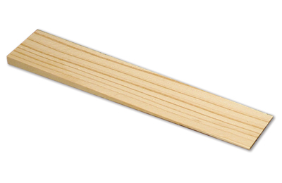

I wound up making two thin plastic squares out of an a wood shim, drilled a hole in the middle of each one, then wedged them between the plastic housing and the trunk lid. Next, I removed the original top section expanding plugs [left the bottom ones alone] and simply used screws to screw them right into my wedges. Tight fit and never falling down again. Took me all of 10 minutes to get this done.

Here ya go.
Step 1. Make I" x 1" widget [a wood shim works great]
Step2. Insert widget between plastic frame and boot lid
Step3. Remove original rubber washer from latch [optional step]
Step 4 Put original rubber washer around screw [optional step]
Step 5. Screw the screw [not too tight...just snug]
Step 6. Admire your work
