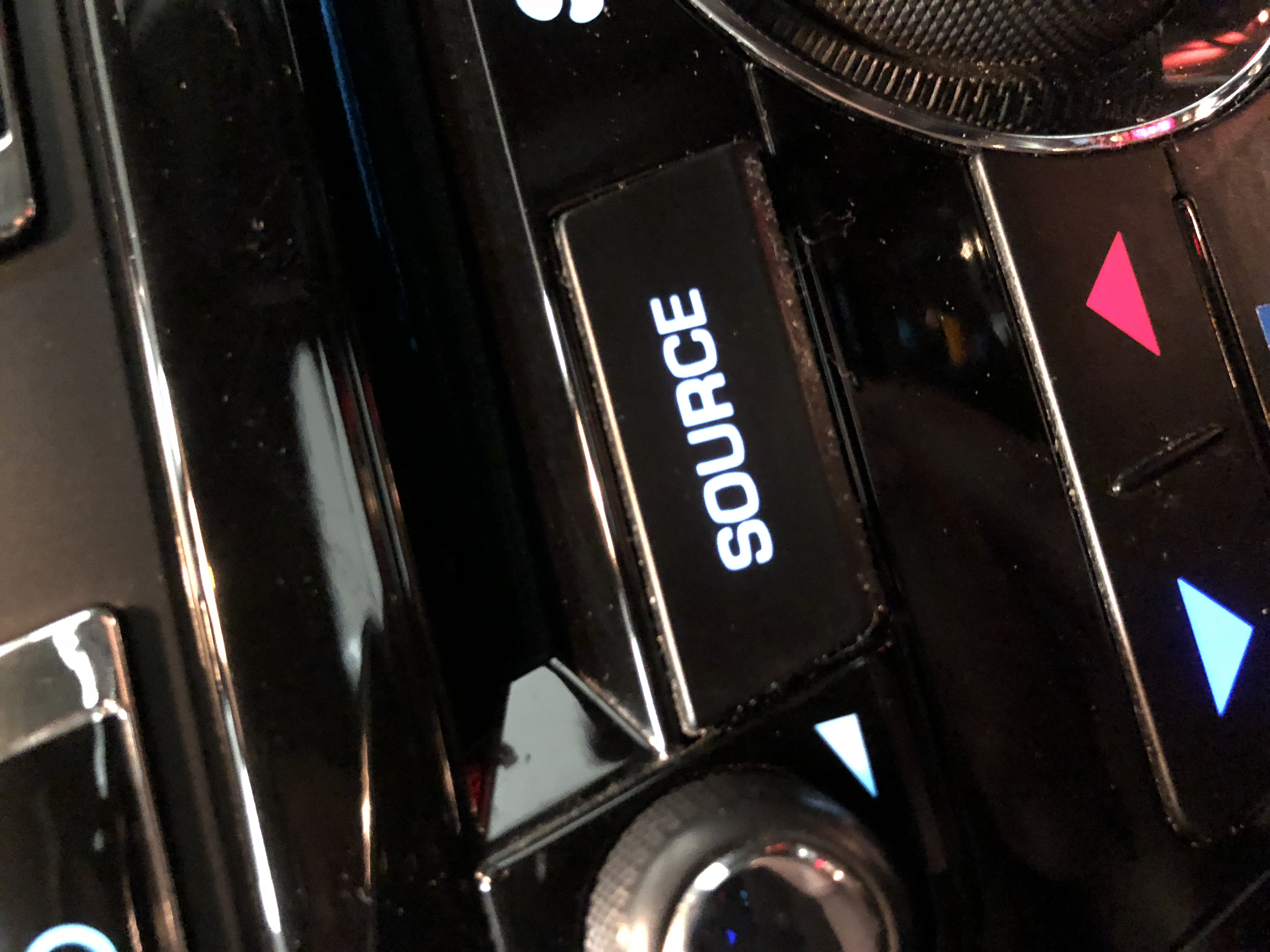

Aw, that sucks. I'm curious to see what it looks like, as that's what I was worried about happening when I first started with removing gummy layer from the console buttons. Did the whole button start smearing and turning white so that everything illuminates besides the original lettering? This is a pic of mine illuminated with all the soft touch layer gone.

The buttons look terrible. The rest of the car is mint. I知 going to get more info on the refurbishment service..
The center buttons for dynamic mode and stuff look ok. I値l try to remove the sticky layer on those.

S-Typer, after seeing this pic of your buttons, I'm going to ask you to take a leap of faith and just start scraping away with one of your fingernails on any one of those buttons (the A/C ones look worst to me). Once you get it going, start using the fleshy pad of your thumb to rub off the gummy soft coat. Then finish by wiping on some Goo Gone. It will be like tough rubber cement residue when you start out. I can almost guarantee the illuminated lettering underneath will stay intact despite all the rubbing and scraping as long as you don't use anything harder than your fingernail. You have nothing to lose since you're apparently already prepared to remove buttons or panels to send off for expensive repair anyway. Your buttons don't look any worse than mine used to. When you said your "Source" button had faded, I thought you meant the lettering had smeared off which would be very different from my experience. But from what I can see in your pic, that's just the gummy layer distorting things because it's dirty and breaking down and no longer as translucent as intended. Just take your time doing one button and see how it comes out.

I値l give it a shot! The car is going in for a new suede headliner tomorrow (actually changing the color to a slate granite color). I値l take my time on those buttons when I get it back Tuesday. I値l post pics of the results!
