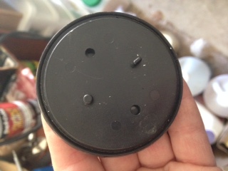

Hi all, my growler on the grill had a crack right down the center (has been like that since I bought the car, she was abused by a PO). I finally got around to replacing it. I went with the same black growler. It took about 2 minutes. I used a razor to get under the old growler, than wedged it off with a screwdriver. It pops right out, as it is held in place with 2 plastic nubs and some double sided tape. New one pops right on. The new one came with the double sided tape on it. Easy. Here is a pic of the back of the old 1 to show the nubs.

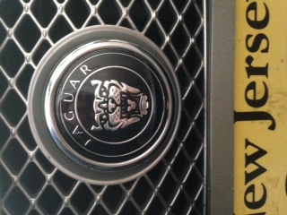

Pic of shiny new growler

Good work. Order is now restored in the universe!
