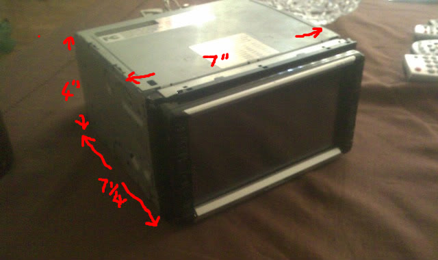

Hi All,
Quick question, I know this topic has come up many a time but I am looking for the maximum depth Double Din unit I can buy without modifying the heating unit for my X-Type 2003 2l Petrol. I know I could fit a deeper unit anyway but I would like it to sit as flush as possible.
A few posts I have seen say around 7"(170mm) and others say around 4"(100mm). Could someone confirm what will correctly fit without modification.

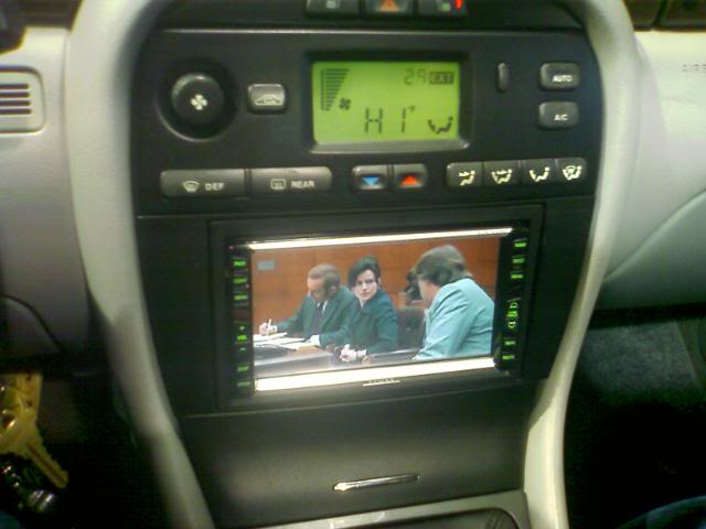

This fitted perfectly when I had it a long time ago

Did it ride right up against the rib?

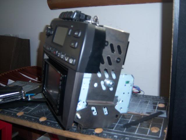

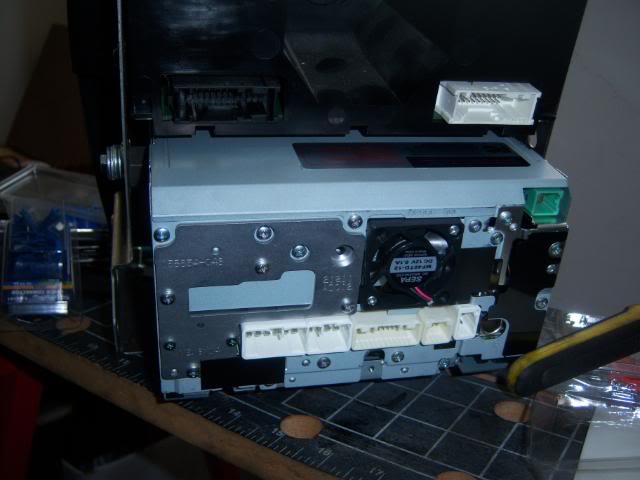

It was so long ago when I did it,I remember that I had no problem with the install,very easy

That 1/4" is useful...it opens up a lot more options for me...
