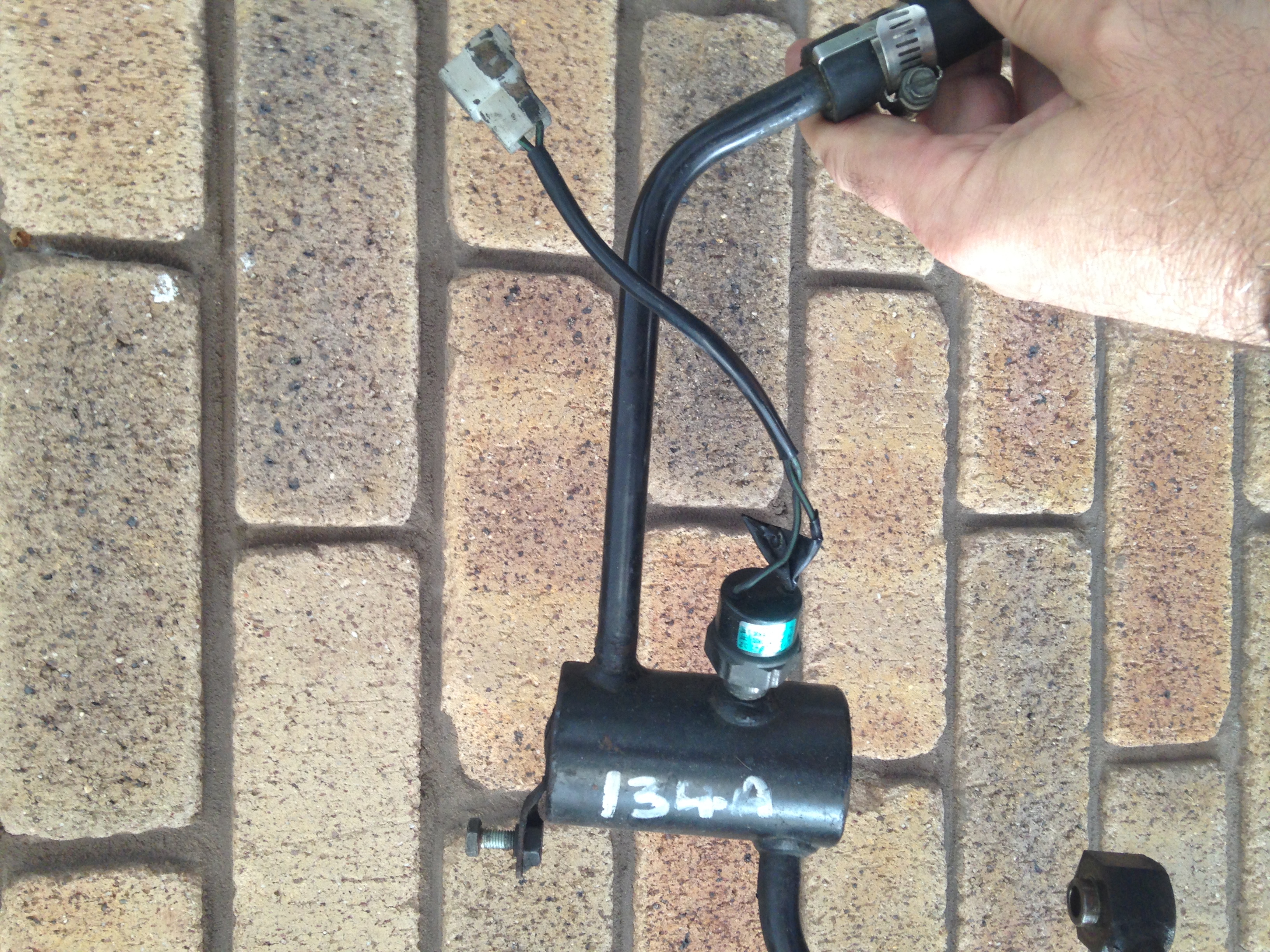

Question is how to wire up the clutch. I have attached a photo of the old silencer and the sensor...junking the silencer so do i need the sensor...?
Do i just wire the Green / Brown power wire into the red wire on the compressor or....?

Yes goes to the power wire that goes live when you switch on the aircon. I do not know what the other wire from the silencer does, except perhaps it was a pressure sensor of some sort. Systems had such things to turn off the compressor if the high side pressures got too high. I doubt you need it with the Sanden. My car never had one even OEM.

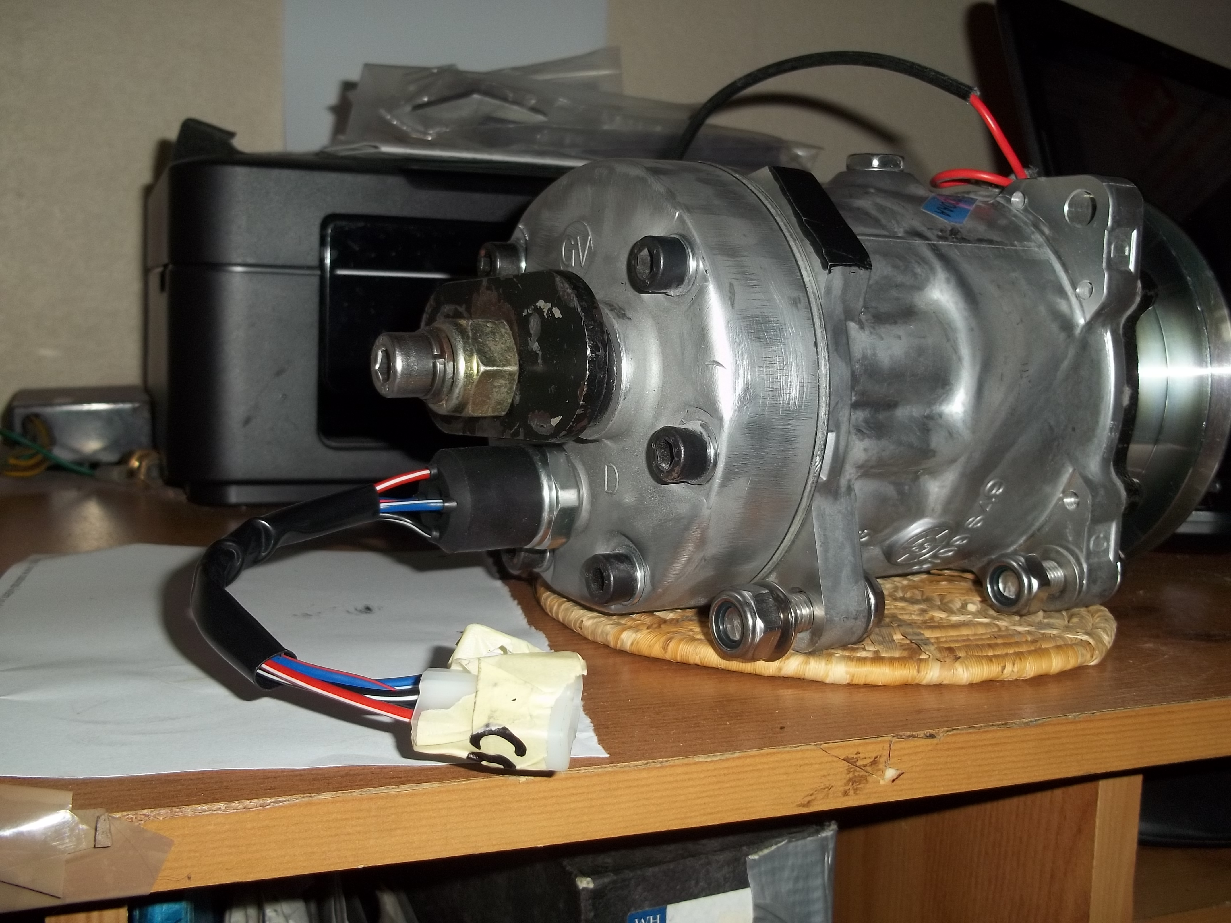

Haven't you got a pressure switch in the rear of the compressor. that plug would go onto
that to stop the compressor in the event of a low pressure In place of the thermal fuse.
the one pictured is a trinary which also brings on the fans when a temp. is reached which isn't necessary as the fans come on when the air con is on anyway, sort of fail safe
