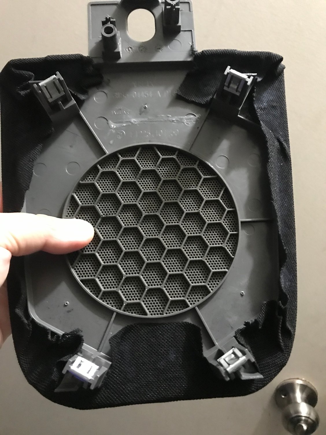

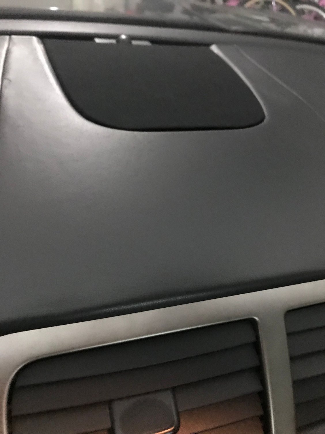

I hope this will help every member either now or down the road. I successfully made my cracked center speaker grille on the dashboard looking new, arguably even better than original. Im sure some of you might be driving around with a cracked grille because the price tag for a new one is almost $200 after shipping and tax. I noticed the front of my grille was completely cracked off about a 1/4”. I couldn’t retrieve the pieces because the speaker was removed when I installed a component set in the doors. Down they went, and during my removal I managed to do more damage in the form of a line crack about 2” long. I’m trying to illustrate how damaged it was, I haven’t posted in awhile so I started taking pics at the end of the project…my bad. Take your time with the removal and take your time with the install because the 2 screws that attach the sensor can be tricky. I super glued all the cracks (doesn’t need

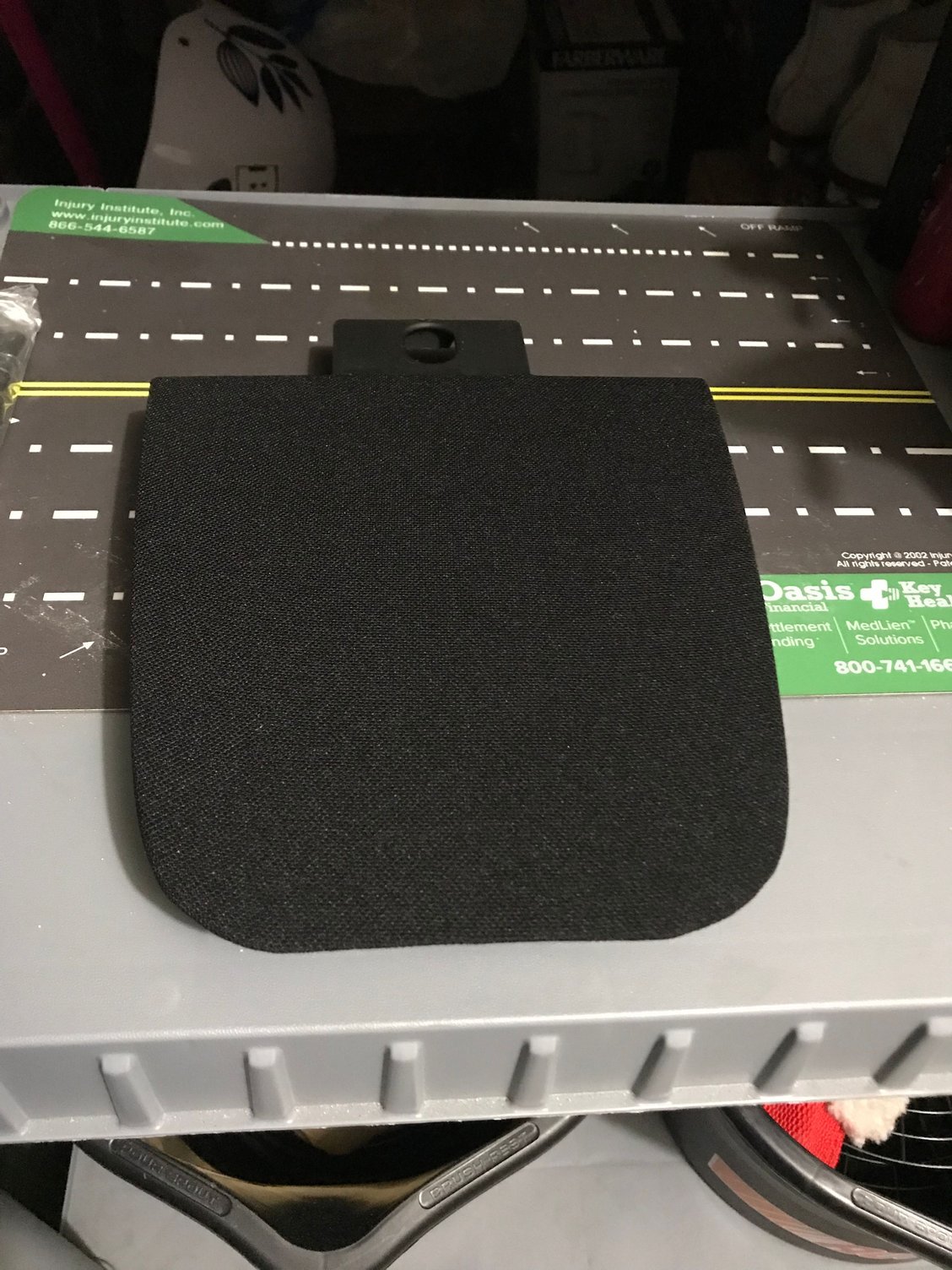

My finished product before installation.
My glue job.
Sensor screwed in. Just line up the 4 tabs and gently apply even pressure and it will pop in nicely.

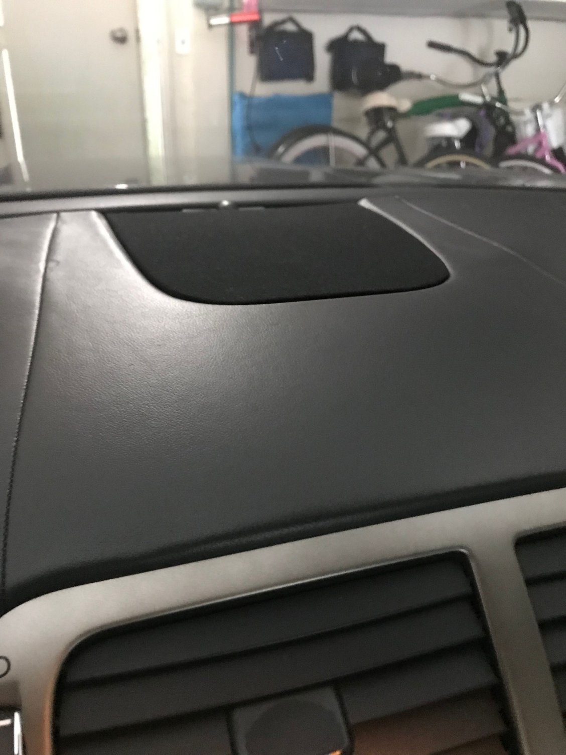

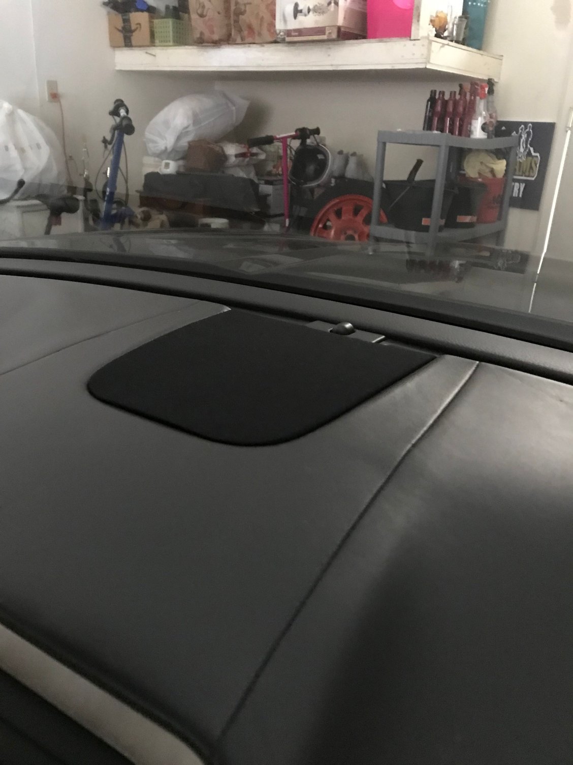

You might like the cloth/leather look better than the plastic hopefully.
to be pretty). In my case I had to shape a new front. I found manila folder was stiff enough to keep the shape, and flat enough to not show bumps. I then got the $4 amazon speaker cloth, cut it, stretched it gently and glued it. After it dried I cut the extra cloth and it looked new. The cloth might look better with the leather to some. Hope this helps and more importantly saves you some cash.
