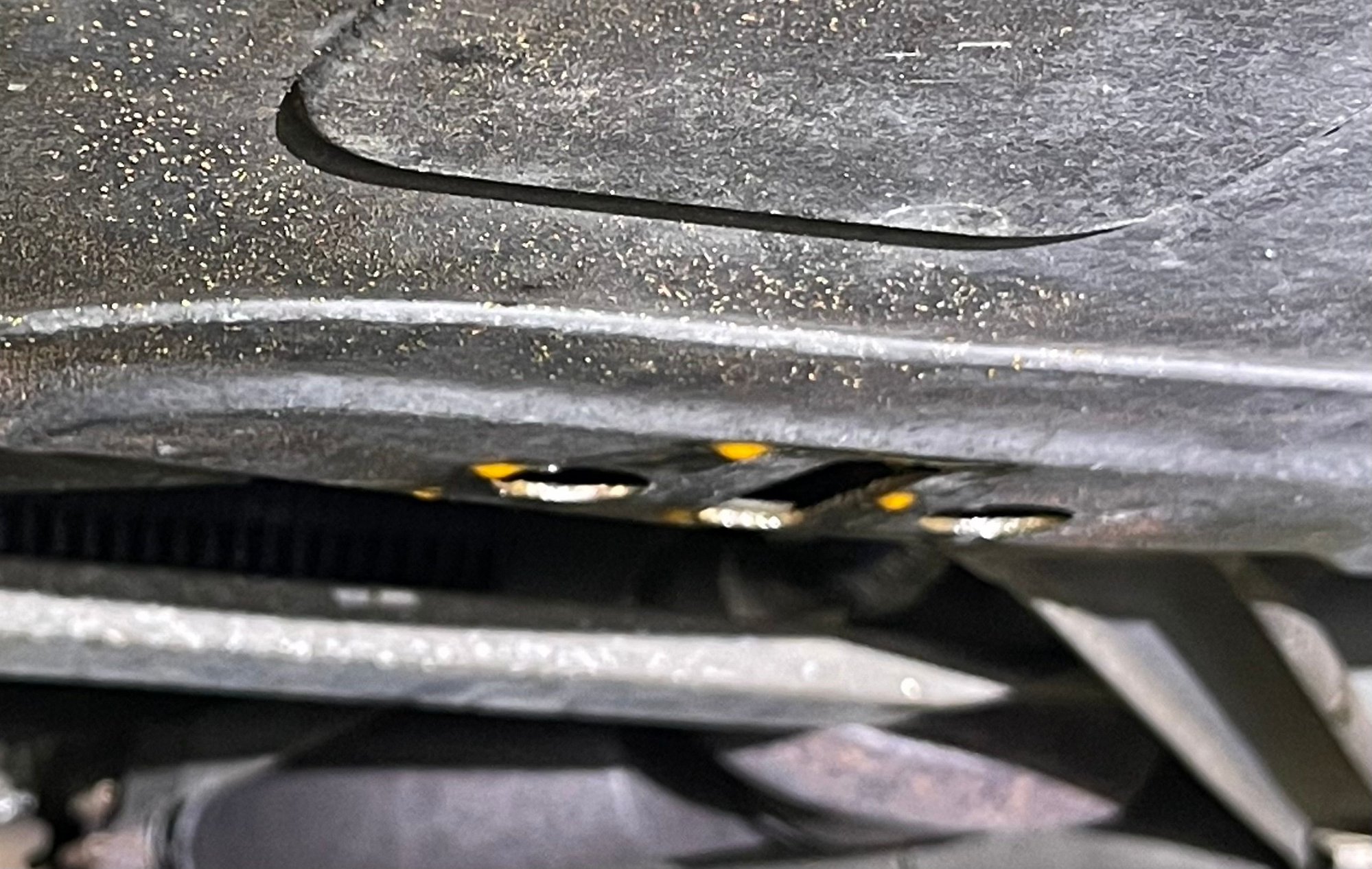

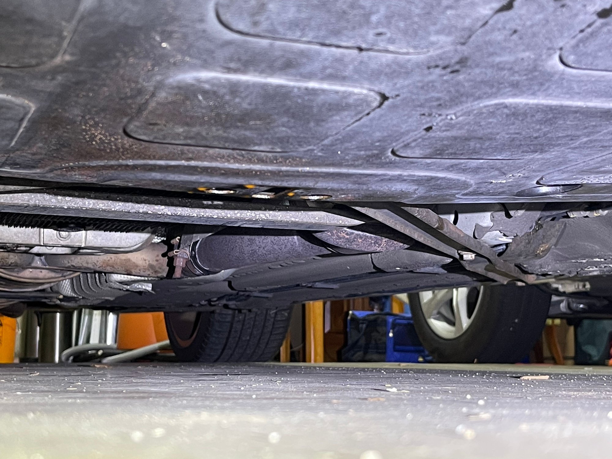

Back her into the garage, grab the flashlight and take these pics:
I can’t imagine a drip from the expansion tank would travel that far with the amount on the concrete.
But who knows?
Edit: It could be dripping down and landing eventually on the under cover which is bowed to center, pooling and dripping out of those holes in the pic. Parking on an inclined parking deck could have leaned it the right way to drain off. Lordie I need to get those jack stands.

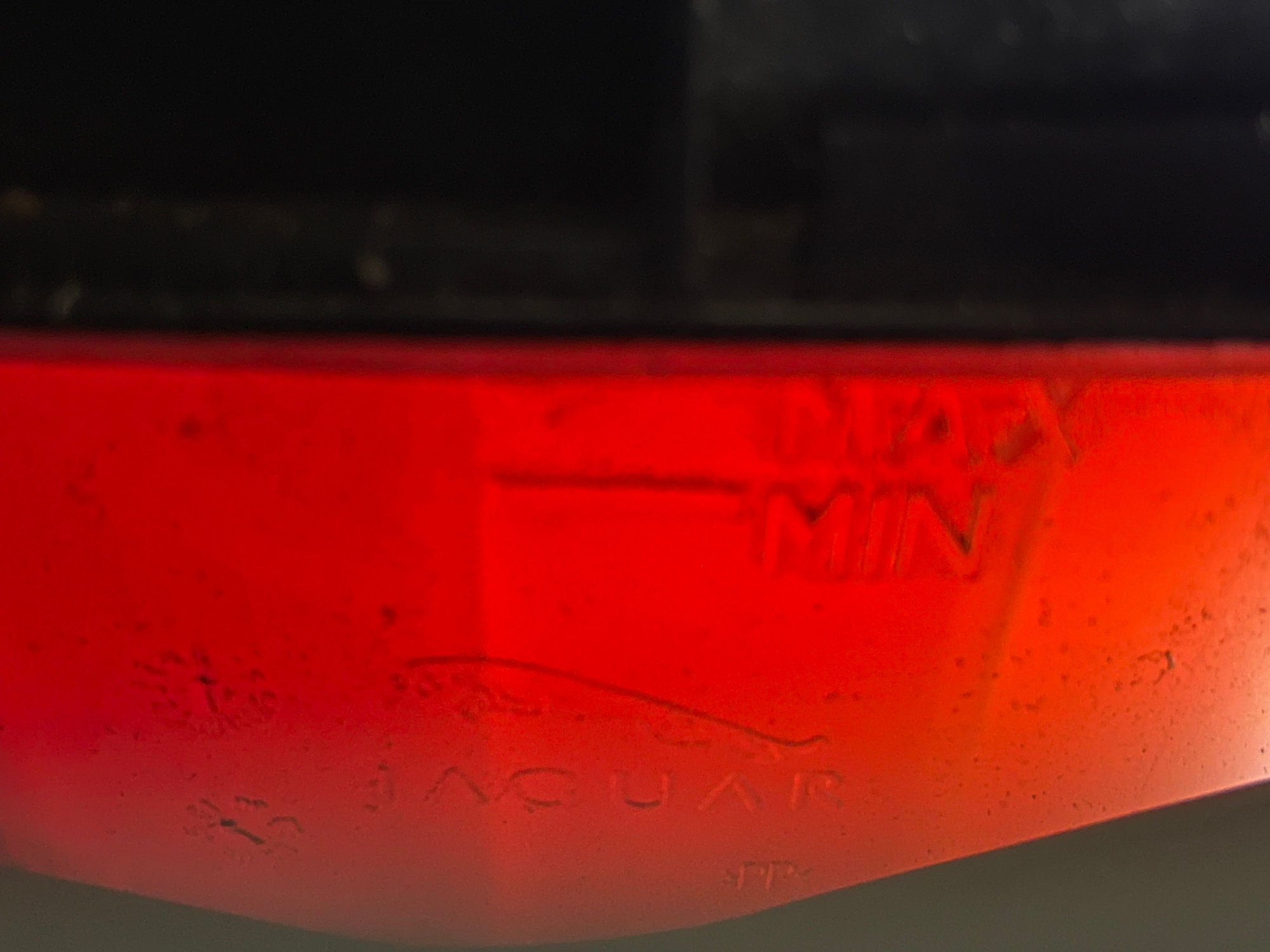

Waiting an hour for the engine to cool and will take pics of the coolant level.
Filled it to the max flat spot last night, maybe a tad over. And when I got home just now, there was nothing on the garage floor. So it didn’t leak last night.
Will update in an hour.
Update:
While it was still a tad warm, opened the cap and it released a bit of air and the coolant had a bit of steam coming out, coolant is at max.
Last Update:
Checked coolant again with engines cooled. It is still a hair above the max marker in the reservoir.
Took advantage of having the cover off to grab pics of the obvious leak:
Weird rubber thing that looks like it is cable management. —^
Zoomed in a bit. Hose connection with the issue is quite obvious with orange caked around the clamp. It is over the edge of the under engine cover.

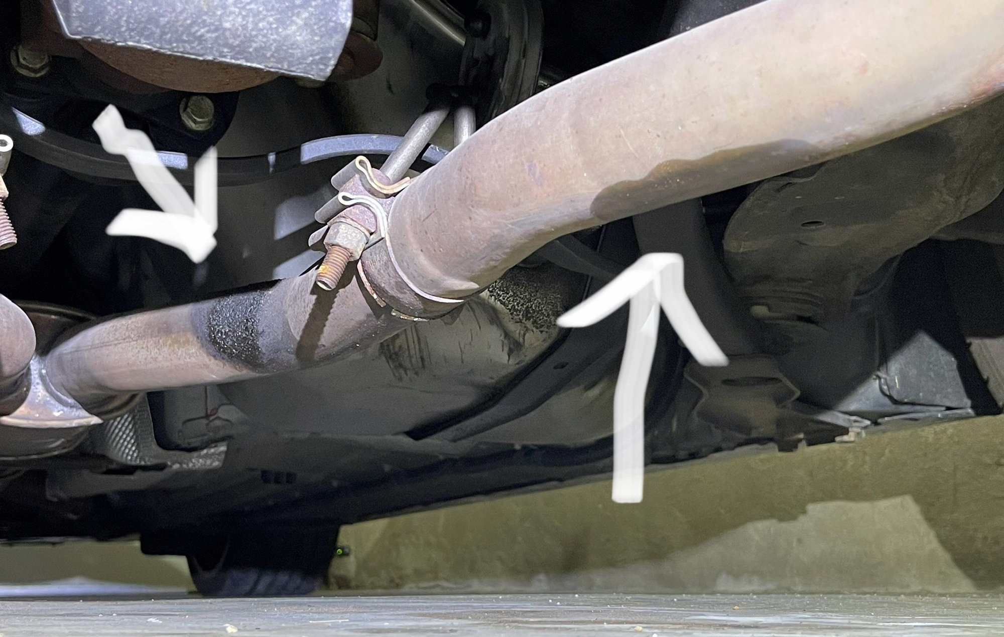

Since I had camera and flashlight in hand, I crawled around and looked underneath.
From the rear, there are these two spots, which the PPI guy assured me were old.
Doesn’t look old to me, but what do I know?
Turning to you guys, the experts on this one as well.

Time for that pressure test.

OK, so seems on her first date with the indie shop, I'll ask that they do a pressure test and get to the bottom of this.
As an aside, any thoughts on the crap on top of the exhaust or the wet spot underneath the other spot?
Or is this just XKR stuff?

I was actually asking about the color of the puddle next to your size 13’s.
The spot on the exhaust pipe? Likely just normal water in the exhaust. Could be coming out the upstream joint and running to a low point on the pipe. Maybe a pinhole leak in the pipe right there, but these are supposed to be stainless steel pipes, so I wouldn’t expect corrosion.
