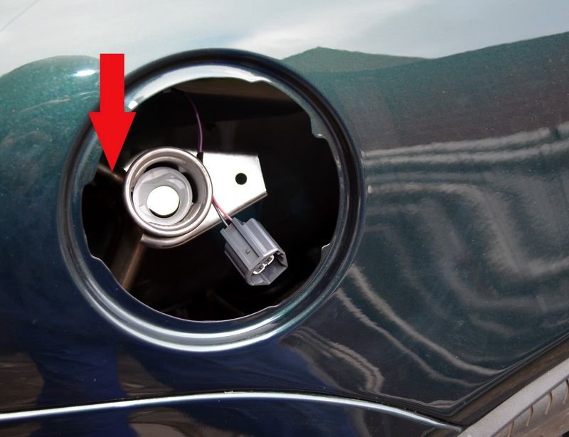

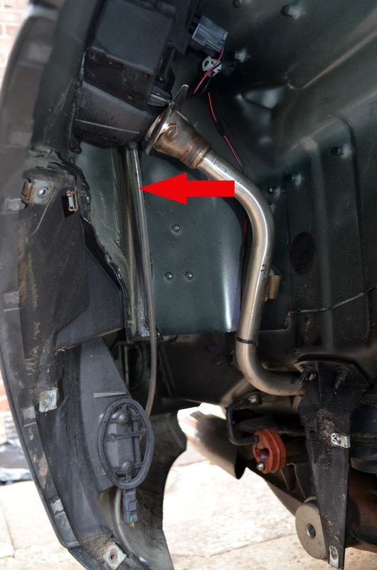

This is the Filler Bowl drain tube which vents below the vehicle:
Is the Canister vent (arrowed in red) accessible from the top of the Filler Pipe? It's normally hidden behind the Filler Bowl.
If not, the lower end (arrowed in blue) should be accessible to check for blockage.
NOTE: this is the European specification Filler Tube. The US specification has a different vent arrangement.
Right. I disconnected the tube in the area of ​​the red arrow and inserted the plastic guide to unblock it. When I have a while I will look at the end of the blue arrow if it can be removed to ensure that there is no traffic jam and if possible I will do the same with the rest of the coal access pipes.
Thanks for your kindness.
Greetings.
