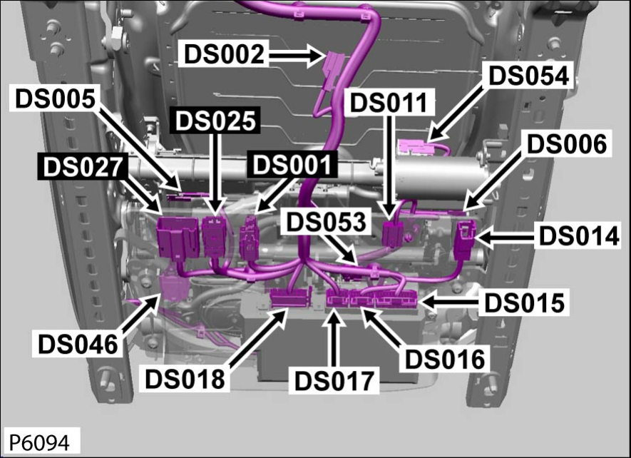

When rebuilting my seats (motor replacements) i missed plugging the heater element back in and I can confirm it will throw an airbag code

DS002 in this example is your seat heater plug. It only has the 4 wires for the heater, so you should be able to disconnect it without triggering any other warnings. This is drivers seat for a random X150, I can double check with your specific model if you tell us what it is.
