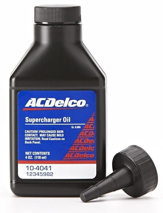

I use the old stand by. ACDelco SC oil. Available everywhere and works just fine.
