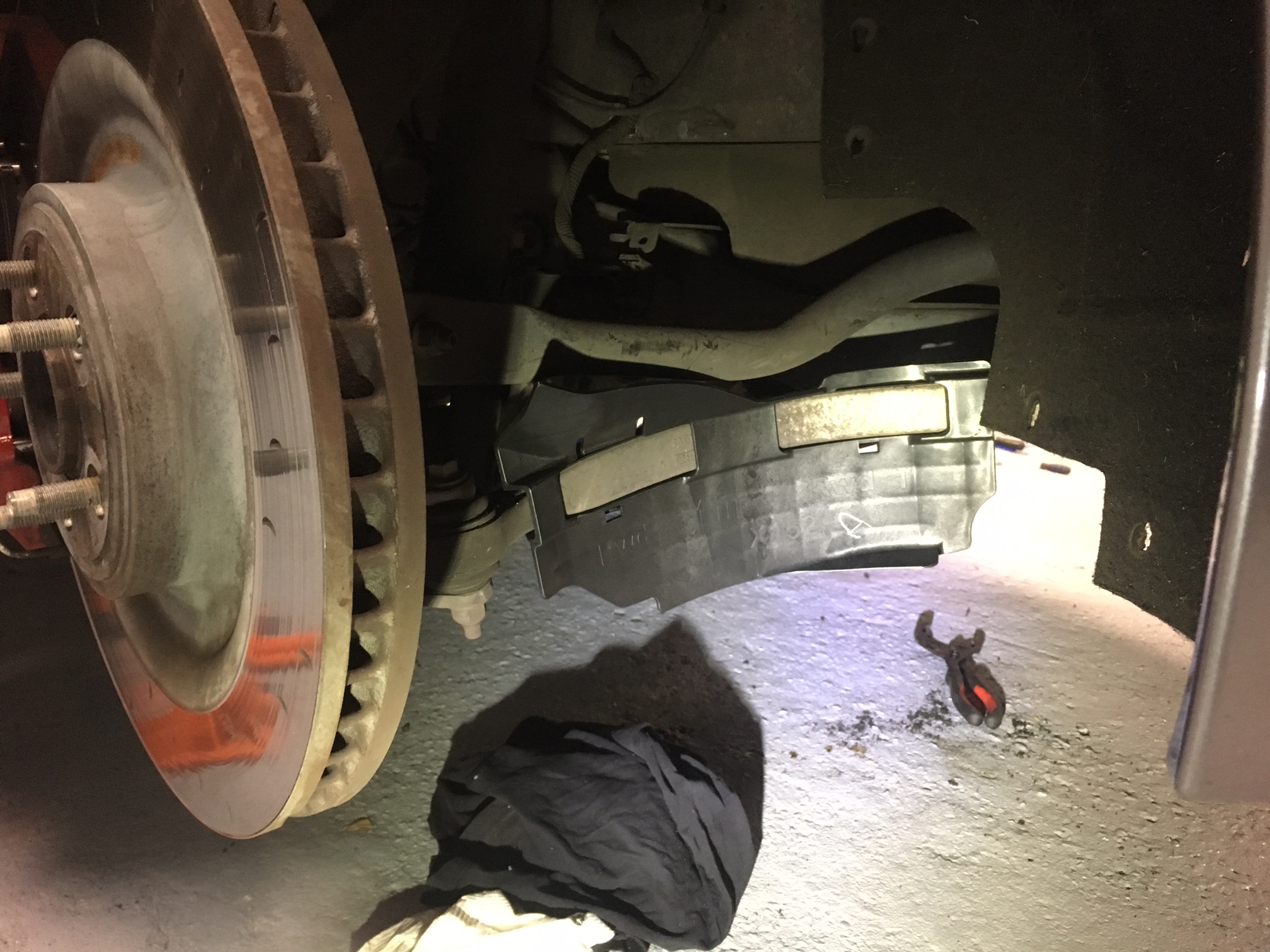

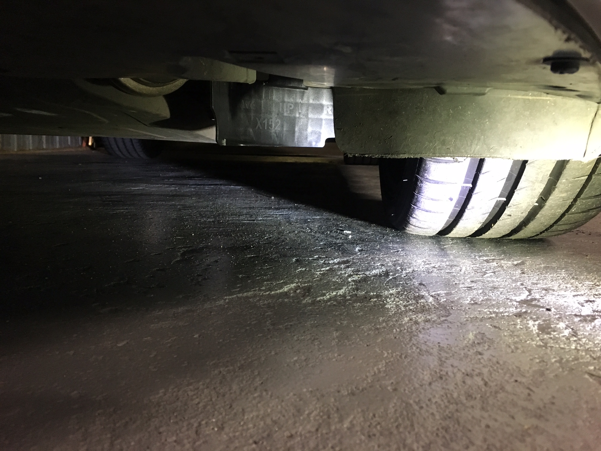

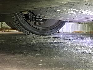

Well, the XKR-S GT / F-Type brake ducts fit on a regular XKR just fine...

They hang down a fair bit lower than I expected, very much in the air stream so you can expect that they actually work.
It's good to see these would be an inexpensive upgrade and would likely make a noticeable improvement on the track. I assume the existing fasteners work?
Zoom into the first pic, they just clip over the existing wish bone arm. Dead simple part and probably easy to duplicate if someone was so inclined.
