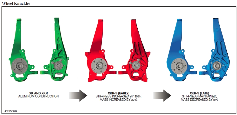

Found something interesting about the front vertical links "steering knuckles" in one of the technical manuals...
NOTE: XKR-S vehicles use specially designed wheel knuckles that provide increased camber and castor stiffness to improve the accuracy and weighting of the steering for greater levels of feedback and precision.
Attachment 140667
I managed to find a pair of the XKR-S (early) knuckles, £300 each from a wreck, vs the £4300 each that they are new from the UK...
Should be here next week.

These things turned up, looking like crap with 70'000 miles of grime and corrosion from the UK's salted roads.
Had to use a hydraulic press to pop the wheel hubs out, they were rusted to hell.
However, it's quite apparent why these things are so damn expensive.
There is not a single casting mark on them. Every surface is machined. The standard XK/XKR ones are cast.
So these are completely CNC machined, from either a rough forging, or a solid billet.
The two extra lugs are in a plane, and have threads in them, I would say that's where it was bolted to the table of the CNC mill.
I'm getting them glass bead blasted, hopefully this won't take away the milling marks on the surfaces.
I guess on the later version they cut those threaded lugs off after the machining was done.

According to the technical blurb these are 30% heavier than the standard ones, but they really aren't heavy anyway. Can easily pick one up in your hand with the hub removed. I'd say the hubs are actually heavier than the vertical links.
