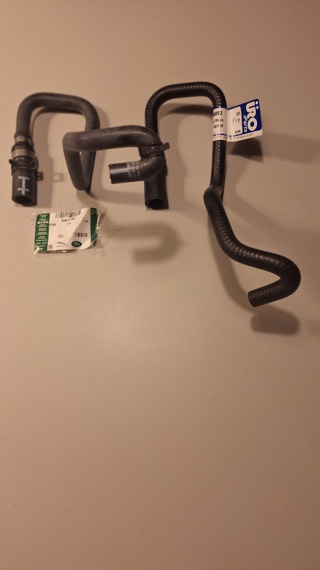

Just to remind new owners of the 4.2 naturally aspirated engines that there is in fact a short valley hose (below). It only goes about 6 in into the valley, then loops back to the throttle body. But it's there, and with the 07's coming up on 19 years in service, it's ready to be replaced. Unless there's someone here who says they didn't need to, the intake manifold needs to come off, meaning those gaskets need to be replaced as well.

Below is the Valley Hose for the 4.2 na. I bought a URO part for around $7, and then decided I'd find the OEM which seems to be a more robust design. I believe you can read the part numbers.
