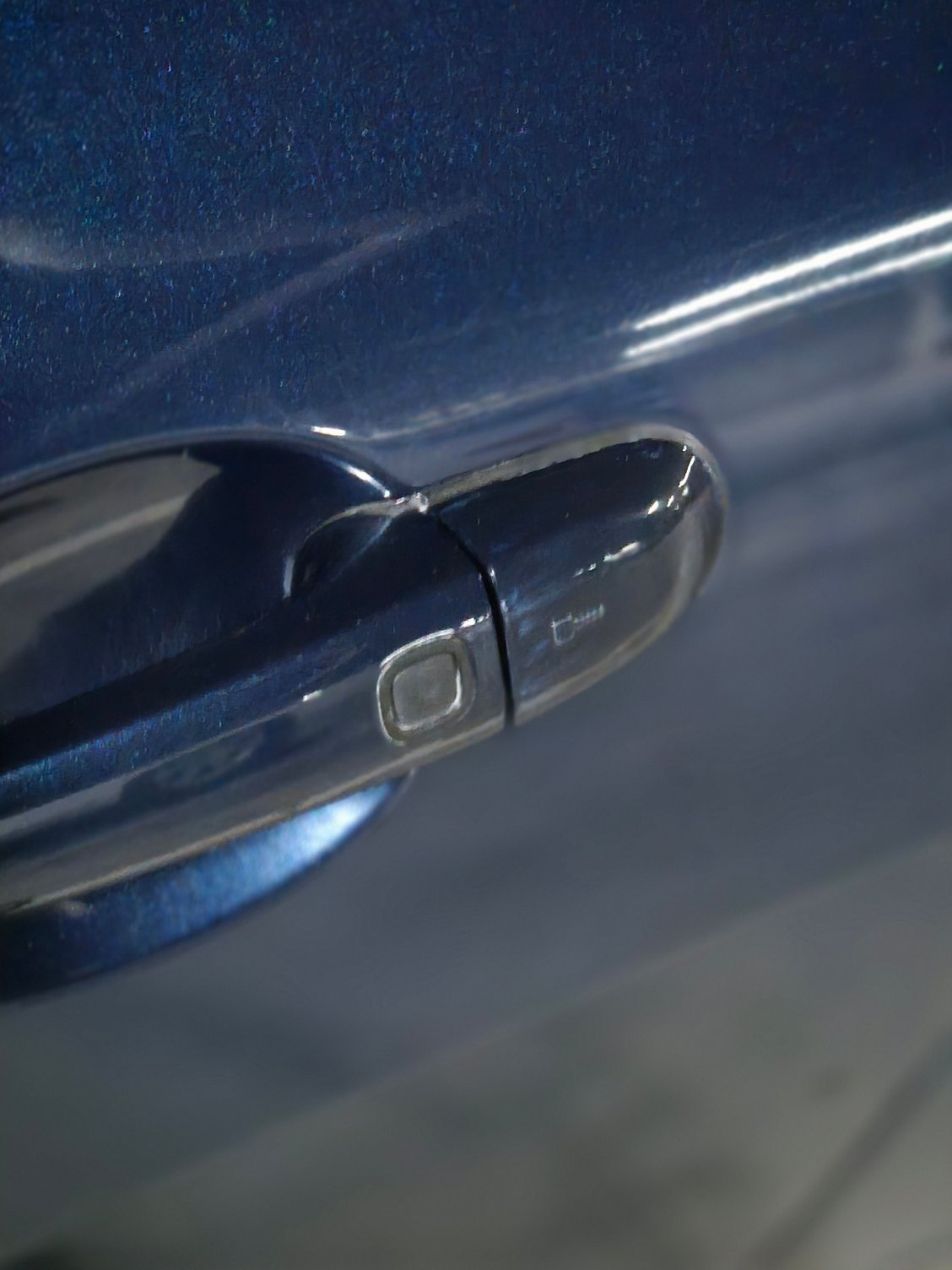

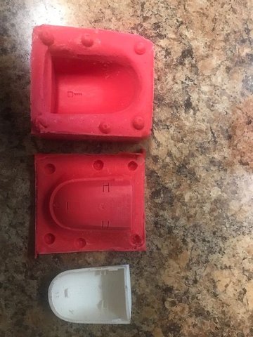

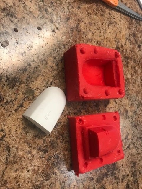

Lost mine, had to buy one off Ebay. these are almost impossible to find. the aftermarket ones are the wrong profile, i tried one. so i decided to try to make my own. i used the one i got from Ebay as the model and made a silicone mold then used epoxy resin to cast a reproduction. turned out great and fits as it should. i only have to paint it now.

will have to do some testing as to how it will hold up under hot conditions like sunlight, etc. it is epoxy resin and not an acrylic plastic. Paint it first and then i'll have to get a heat lamp or put it in the oven at 100 degrees to test.

i'm experimenting with different casting materials. the stuff i used i already had from a different project and it takes approx. 72 hours to demold, that's way too long for any kind of mass production. i tried one product that resulted in too many air bubbles in the finished product. i'll try another product and let you know.

HARD TO SEE THE SMALL TABS ON THE INSIDE

thats the listing but i have just 3 made as of now and then i'll have to remove the listing until i get more ready. it takes about 7-8 days to make one and let it fully cure. its a slow process. i can't use marketplace as i have not made enough posts i guess or can't figure out how it works.
