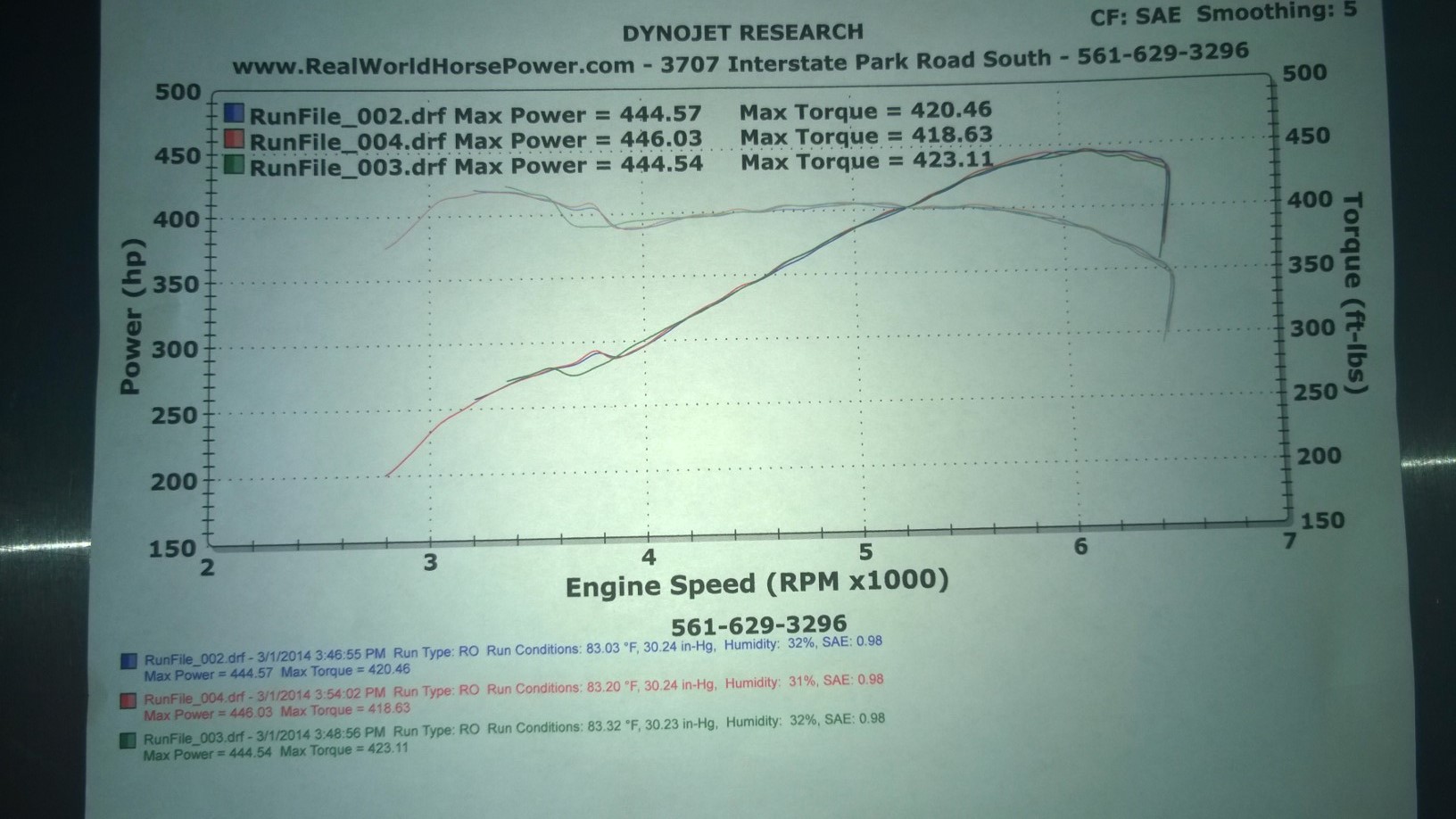

So after some emails with the brtis who wrote my tune it was discovered that it was reverting back. There seems to be an issue with their tune tool and 2013+ models where the ECM sets the maps back to stock after a few hundred miles. The fix was to apply the tune shut the car off immediately and disconnect the battery. Wait 5 minutes then reconnect. This seemed to help until I went to the Dyno Saturday and got horrible results.
I'm going with Eurocharged hopefully this week if Jerry is ready with the tool.
Also does anyone know how to clear the "service alert" you get when you disconnect the battery? I did the parking brake reset but I remember there was something else that needed to be done.
One other thing Dynoing these cars is a pain.. You need to remove fuse 20 for the DSC pump but also after you get it in started you have to remove fuse 3 for the ABS pump. If you remove it before you start the car it will not start.
Attached Thumbnails ECU Tune and Pulley Upgrade Satisfaction for 5L SC-wp_20140301_17_27_56_pro.jpg

sorry to hear your trouble with your tune. Llooks like a standard XKR-S dyno run. Good luck with Eurocharge.

Exactly look like a XKRS tune thats it, and the part that gets me is that I have an exhaust and 3LBS pulley(so they say). Looks like this tune just caused the throttle to activate quicker giving the illusion of more power but easily explains the power drop off at higher RPMs.. My higher trap speeds are solely due to the exhaust
At least this vs the wheels was paid with me CC so I can get the money back today.

between your trouble, although with a different tuner, and the guys who did F types and not show a real improvement at the drag strip this is starting to leave me wanting. I had all my P cars remapped, tuned and even turbos added with significant hp gains.
This car already can spin the tires in normal mode with DSC on into third gear. Not sure I am still sold and hot on some extra 80-90hp. Again not likely you can feel it, it is for my ego only for sure but has anybody else gone back to dyno their car to see if the tune sticks?
What if the ECU rolls everyone back, would you actually be able to feel it or accurately measure it with smartphone apps?
