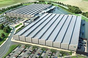

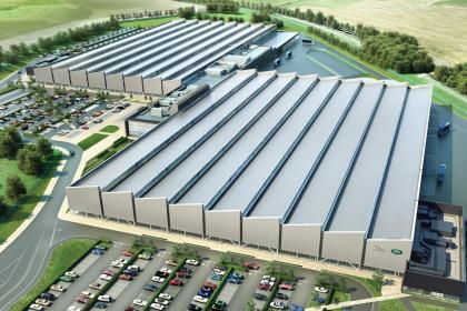

For as long as Jaguar has built the V8 in its "factory within a factory" at the Ford Engine Plant at Bridgend in South Wales, the engine number has the build date and time off the line assigned to it.
