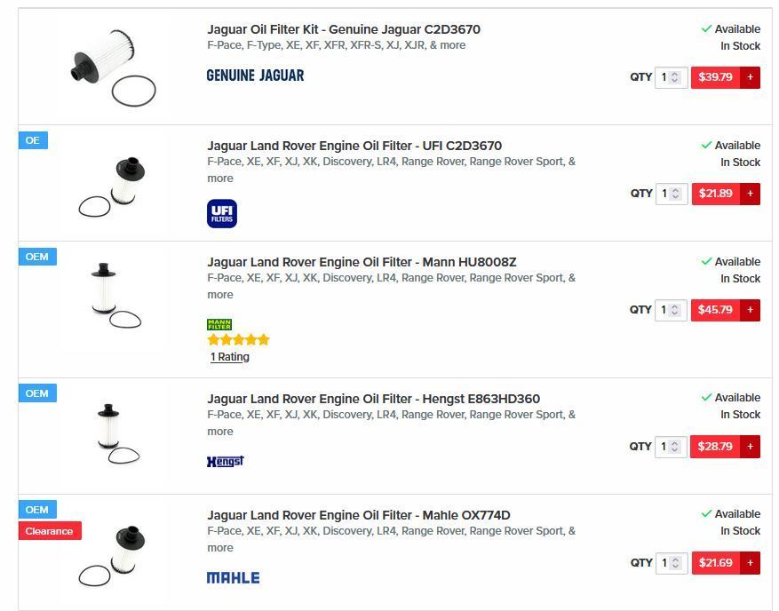

Below is FCP, where I've been doing business for 10 years for three BMW's and my XK. Lifetime guarantee. Free shipping over $50. Mahle for $21 is a steal.
Most of these brands are of the highest quality (I don't recognize UFI) , but wherever you get them, get them from a trusted parts house.
