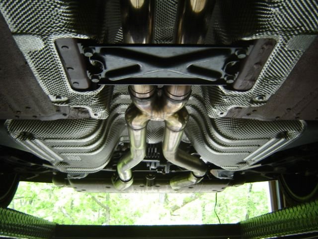

Only need one X pipe. The picture is of my OEM performance active exhaust system that was an option from the factory on my 2012 XKR. No drone and both comfortable or brash regarding noise . Just depended if you run with the exhaust valves open or closed.
Thanks Jagtoes . Looking at your photo you have replaced the second of the resonater boxes with the Xpipe , Is that right ?

Jagtoes, looking at your photo it seems to me as from the Cats yours has then straight pies to the X box then pipes to the large rear box "muffler, were as on the normal xkr their seems to be 2 resistor sections that have to be converted into X box , so will tell mate to get them both changed to X box
I'll try to explain it again. The picture you see is from the Jaguar Factory. I did not modify the system . It is OEM. The pipes from the Cat's are straight to the X pipe and then straight back to the rear back box. This is the OEM option PAE , PERFORMANCE ACTIVE EXHAUST that came on the car from the factory. You only need ONE X pipe . You can buy this pipe section from Jaguar. It has a Jaguar part number. It is not aftermarket.

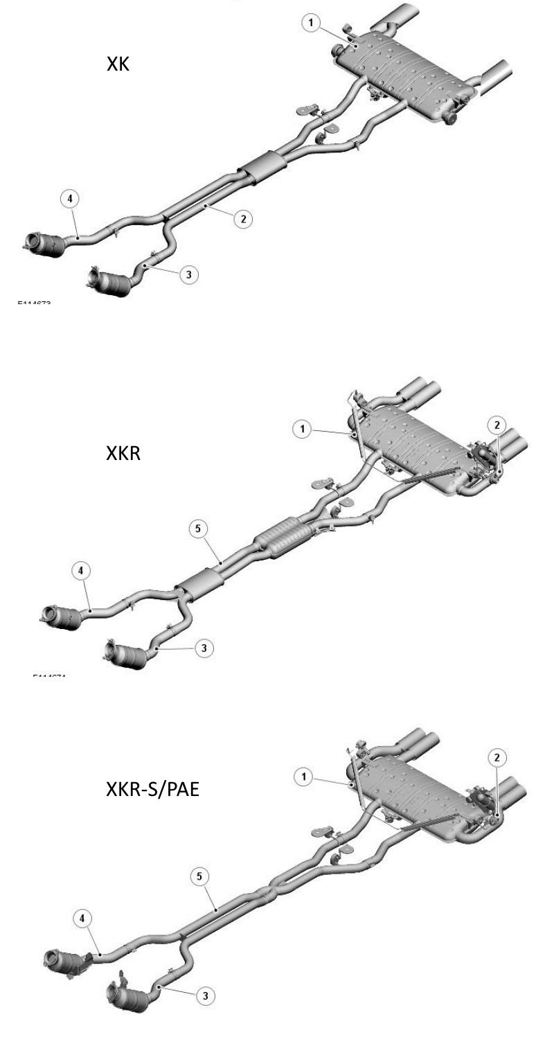

From cats straight pipe taking out first resistor , then install the xpipe in place of the second resistor , will advice my friend . Thanks guys
The resonators are all in one piece. You take the whole section out and replace it with an x pipe.
These were the three options available:
