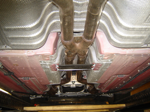

Originally Posted by pk4144
Since the car is a Final Fifty, PAE was standard-- it was part of the Final Fifty package. I just don't see where/how the X pipe would fit.
And there was no trade for this car. They bought it without making a sale.
Final Fifty Convertible FS-23658396_1779695139003062_1371531485157921432_n.jpg
This is the centre pipe from the PAE, XKR-S, etc
There are not mufflers or resonators, just the x-pipe.

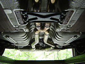

This is my 2012 PAE option at $1400 according to my window sticker.
Attached Thumbnails Final Fifty Convertible FS-dsc00091.jpg   Final Fifty Convertible FS-dsc00092.jpg
$1400 on top of the cost of the standard exhaust. When you have to buy them as spares it's more expensive.
The centre pipe is $1330, the rear muffler $4750, USD, according to some US-based dealer online shops. Plus taxes, etc...
EDIT
Does my head in when people remove the PAE from a car, half the time they throw the damn things out without realising what they cost!
EDIT again
You guys get ripped off in the states for these, in the UK they are $925 and $3300, respectively.
