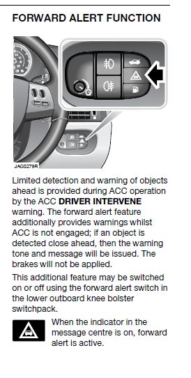

Hi, I have both now showing on the dash of my 57 plate xkr which has done 76k miles. I have lost the manual and have searched the forum to no avail. Would love to hear what the possible problem might be associated with the triangle around a car warning light might be, I appreciate the other will need diagnostic, which its having tomorrow morning at a main dealer.

The triangle with a car inside it sounds like the indicator light for the Forward Alert. You haven't pressed the button without realising have you?
It is in the little cluster of buttons with the fog light switches etc, between the boot and fuel filler flap buttons.
Attached Thumbnails First an amber engine light now an amber triangle with a car in it!?-forwardalert.jpg
