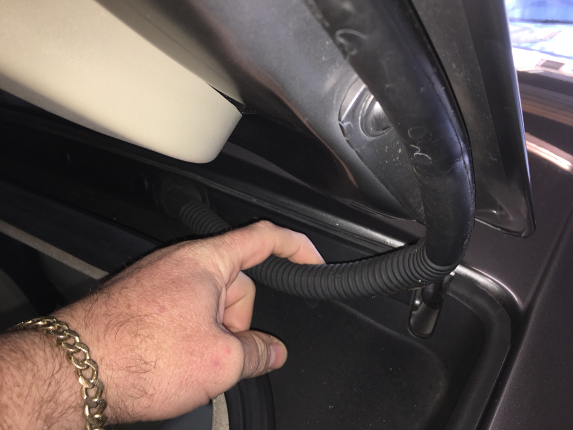

Maybe the coaxial antenna cable in the rubber boot to the hatch is coming apart, from the movement, have heard of this happening.
I had this happen on my Lincoln LS, the insulation between the shield and signal cable shrunk and they touched. Wala, minimal signal.

Originally Posted by Sean W
Thanks. There's no rubber boot though. This just feeds around the wall, not tightly either. It's not rubbing against anything up to the entry in the cabin.
In here
Old Jul 23, 2019 | 06:57 PM
Sean W's Avatar
Joined: Jun 2013
Posts: 8,946
Likes: 4,747
From: USA
In here
in the 07? I have the mast on the fender wall
