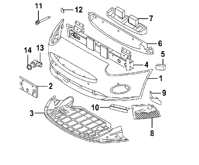

Insert, Lower Cover (item 8)
2007-2009 Right=C2P13688XXX Left=C2P13687XXX
Search the site a bit, we have had another member do a similar front end upgrade, and could provide valuable info...
