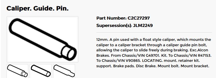

I will have to check the car tomorrow. Isn't this a picture of the rear caliper though? And still, Jaguar still lists this was 12mm when I keep getting 9mm bolts
https://parts.jaguarpalmbeach.com/p/.../C2C27297.html

12mm is the total pin diameter, M9 thread
there’s also a 16mm M10 guide pin on some cars. that’s what i sent you. under the rubber cover are your guide pins, guaranteed.
