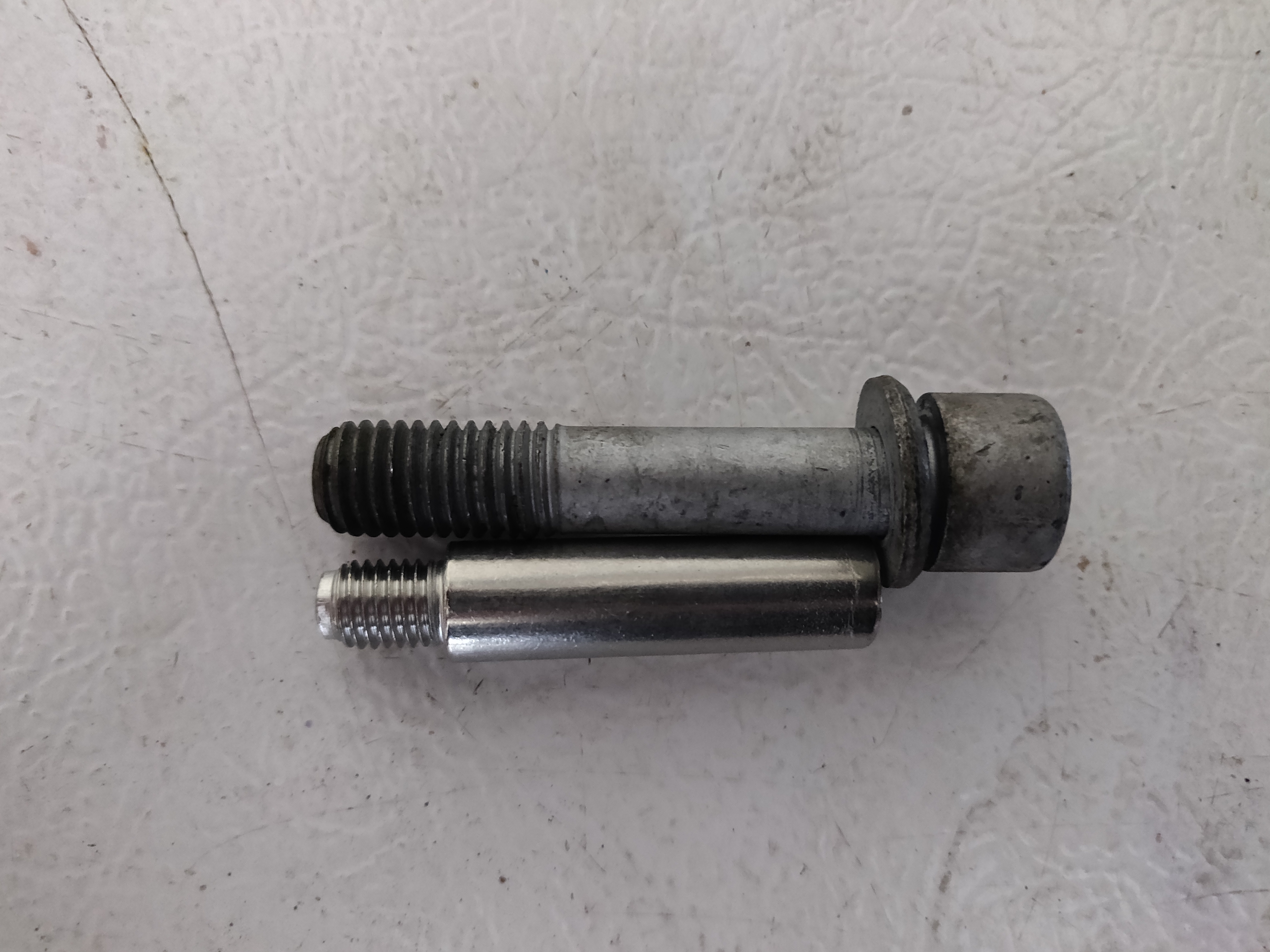

Does anyone know the part number for both the caliper bolts and the slide bolts? 2007 XKR, front brakes. Bolts have a T50 Torx. RockAuto and Amazon are both incorrect and send smaller bolts.

Just checked my parts list and the bolts WERE C2C27237 but that has been superceded to C2D27400. There are two types of guide pins listed, the first being 12mm diameter (C2C27297) and a 16mm version
(C2C29162). Both those numbers are current. The aforementioned is for standard braking systems (ie - NOT Alcon or Ceramic as per XKR-S). Hope that helps.

Well that didn't work. People keep sending Dorman HW5025 and that is the wrong bolt! Amazon, Rock Auto, and another ebay seller who specifically listed it as working for XKR.
The real bolt is M12 thread by about 36mm. May just try McMaster before I break down and spend $90 on 3 bolts from Jaguar.

Holy HELL despite being listed with C2C27297 on that amazon link AGAIN I got those goddamn 9mm bolts. 0 for 4 on this. I'm about to give in and just pay $90 for 3 fing bolts from the dealer. The correct front caliper bolt is M12, 72mm in length, and has a T50 head.

The top bolt is the working guide pin that came out of my 2007 XKR. The C2D27400 (Caliper bolt) I already ordered is correct and fits. The guide pins from Amazon, Rock Auto as being compatible with this exact model (and C2C27297) are not compatible. The bottom bolt is the stupid small bolt I keep getting over and over and over and over.

Can't be right, it says m10 when I just measured my bolt as m12. All jag sites list the bolt as 12mm
