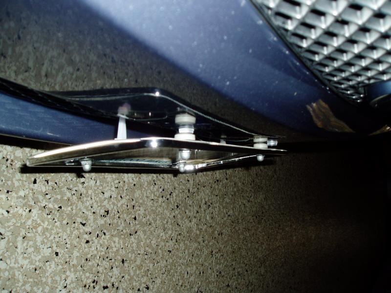

Default Mounting Front Plate
This isn't the best, but works for now, Used clips that one uses to go through sheet rock holes that spring out, Bought a generic plate bracket that is marketed by Volvo, and mounted as shown, Used Ty Raps to steady.
Best part so far is no holes in front of car.
I can send you more info if you wish.
