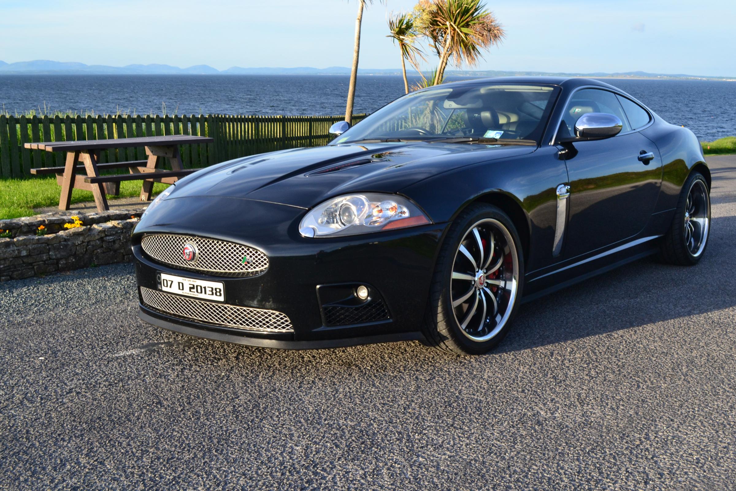

I fitted one of the new 70 mm red badges to my 200 xkr. Got it on ebay
Genuine Jaguar new style grille badge red (70mm diameter) | eBay
Mine had the old green badge, just go round the old one with a small screwdriver and it will pop off. Take of the double sided tape off new badge and put some silicone on the rear of badge, get silicone such as "no more nails" sticks in about an hour. The old badge leaves a chrome ring behind on the grill so fill it with silicone to make up the gap. Then push on, as the new badge is slightly bigger it will just push a small bit into the chrome ring. Will sit out a bit, but looks ok and factory looking.
I changed my rear XK badge for the new one last week, have no pics yet, got on eBay too make it more modern and nicer badge i think item no; 231231717034
hope this helps here's a picture or 2

no need bruce, i used silicone called Teck3 ,when cured when you pull at badges the grill moves. I have the same R badge on the front as rear,as in pic, removed double sided tape then applied silicone, no problem.

yes steve the badge is on the same centre line as middle badge, and from edge of centre badge to slope on R badge is 10 full holes as in pic, looks good to me.
