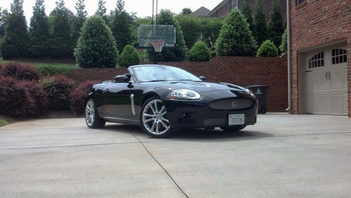

I also have a front plate. But I basically mounted it using one of those cheap $5 plate holders like this:
However, I mounted it over the front grille. To do this I used toggle bolts, and some thick rubber dishwasher tube, which provides the spacing. The plate hovers over the grille and doesn't move in high speed. We'll see how the rubber holds up through the years, but it has been fine for 18 months now!
http://www.floridatoolandfastener.co..._300-01-01.jpg
The result is not bad.

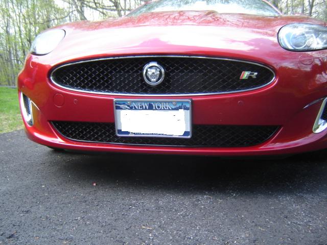

I considered that unit but there is not enough room under the center section of the bumper. You would have to mount it under the nose to have room for the lower bracket. If you want a low plate then it will work but if you mount it close to the original mount it won't work. I know it won't on the 2010-2014 front but maybe the older years it will work.

That is inventive.
I assume the bolts go through the center of the tubing to prevent damage to the grille as well as provide the spacing - do you need four bolts to keep it steady or will two suffice?
