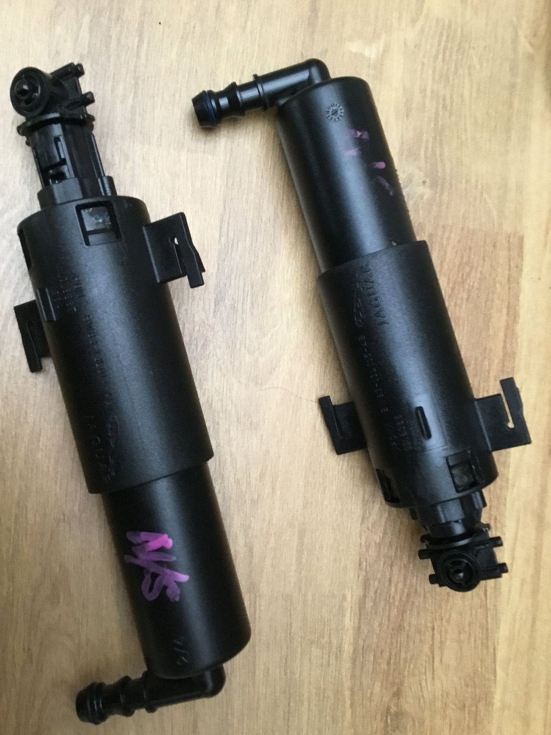

Ok so these are the offending parts. Nearside (left) is stuck slightly out, but otherwise okay - it is not blocked and it moves out and springs back. Offside (right) was stuck solid; I’ve managed to get it moving but it’s blocked and I can’t blow through it.
I managed to remove the end jets but cannot work out how to dismantle any further to clean effectively.

will a vinegar solution help?

..............................I managed to remove the end jets but cannot work out how to dismantle any further to clean effectively.
Ultrasonic parts cleaner???
