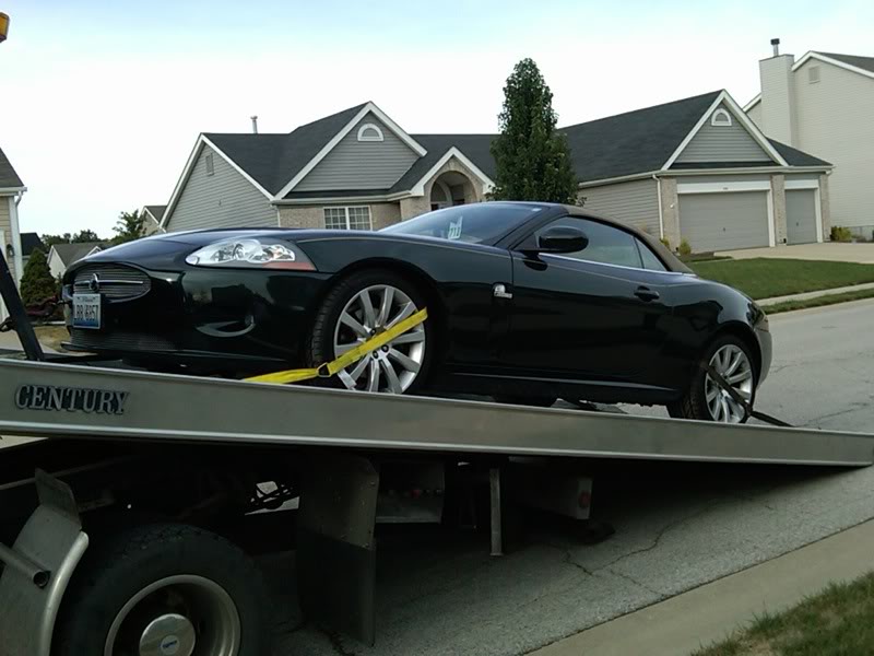

Here's a photo of the car being returned to me
