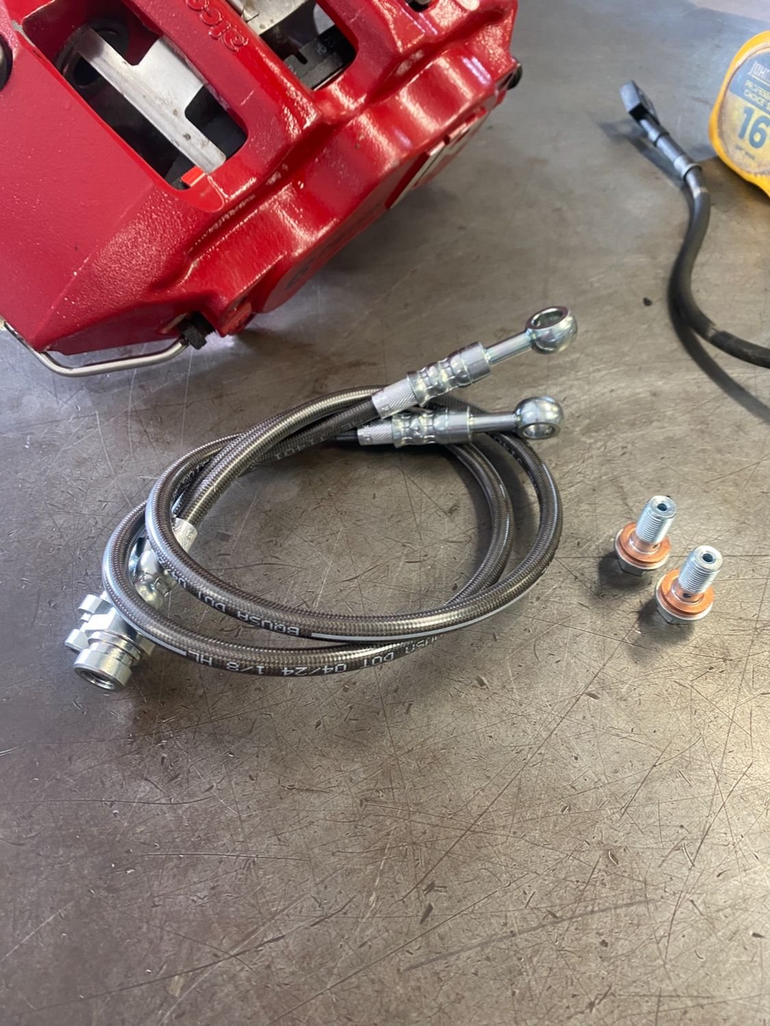

I had custom brake lines made to order when I upgraded to the Alcon big brake rotors. If you are interested I can forward tge info to you. They are located in Orange California.

I ordered front 24 inches due to steering left to right play and rear 20 inches. Banjo fitting to calipers and cone fitting to brake lines
