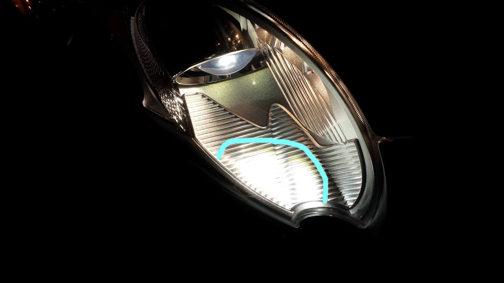

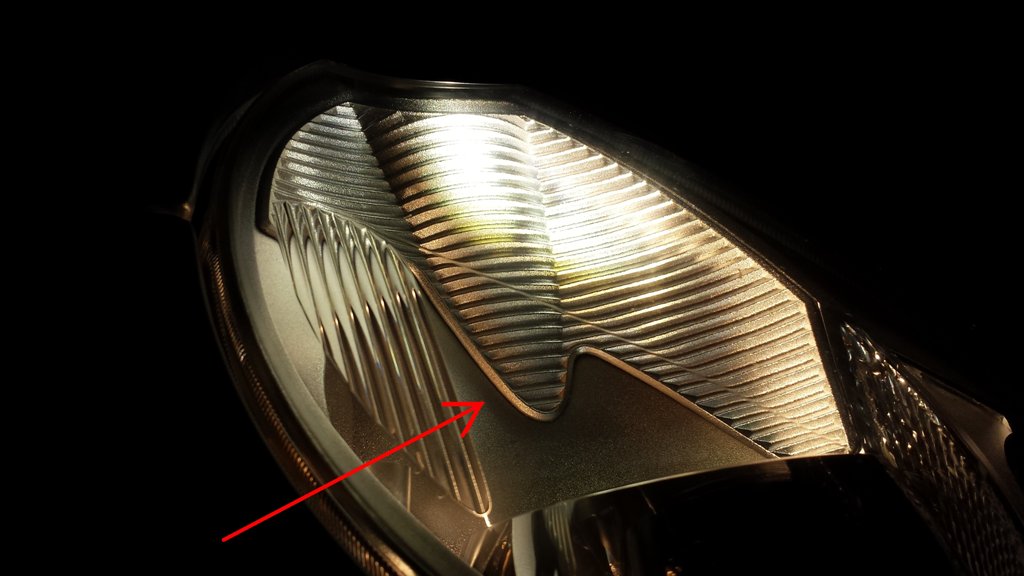

I have discovered something interesting when studying my headlamps...
It seems there is an "added in" plate, inside the lens housing. This plate is clearly in path of the beam (marked in blue), and seems to be designed to deliberately scatter some of the light upward.
So a question come to mind: Is this plastic piece on all the early (07-09) Jags, regardless of country?
It looks almost applied as an after thought, and I wonder if it is possible to remove it, allowing more light down range.
Thinking out loud....

That "up-scatter plate" is a US DoT requirement to illuminate reflective, but unlit, overhead road signs. A few years ago Buick were told to recall a bunch of cars because the up-scatter was deemed inadequate. The US DoT does not like the European style of sharp low beam cutoff because of all the unlit overhead signs in the US.

So are you saying Non-US models do not have that plate?
I'm guessing not. European lighting regs are strict with regard to light above the cutoff. Maybe one of our UK/European owners will chime in.

This is from my RHD Japanese spec '07 XKR.
According to the parts manual there is only one part number for RHD cars in my VIN range with adaptive lights so I assume they will all be the same as mine.
+1
UK doesn't have this insert.
The RHD markets all have the same two Adapative or Non Adaptive options. (arrowed in blue in the following Parts Catalogue extract)
The US has had 5 changes headlamp in both Adaptive and Non Adaptive making 10 possible headlamps. (arrowed in red)

U102 says his RHD has the defuser, but GGG's RHD does not....
I'm not sure this is the whole reason our HIDs do not equal the power of my two prior cars (Lexus and Audi) but I bet if we could get that diffuser out of the light stream things wold certainly be a lot brighter down range!
Hummmm wonder how hard that would be......
