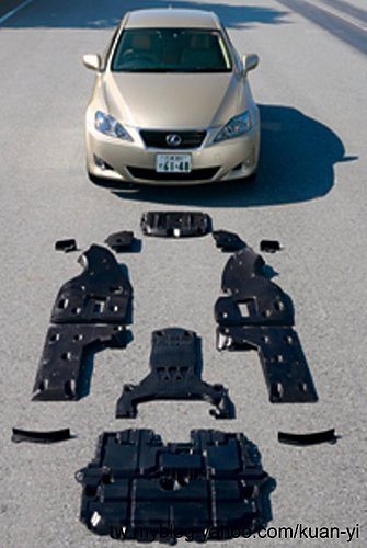

I'm interested in DynoMat deadening myself, and may look at it as a fun project for the rear wheel wells.
It's unfortunate for our lack of production numbers, but my old Lexus IS350 had undercarriage options you could order from Japan that were said to improve sound deadening by a lot.
