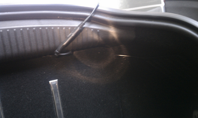

This is exactly what I have, I cut a small circle in the rear boot lining and pulled the end of the connector through that, then put in a rubber hole grommet and it looks very professional and so easy that my wife connects and disconnects it for me if I have to go away at very short notice. Cost about $10 for both items.

Tourputters, a pic would be appreciated. I've been contemplating the same thing, but wondering how to stabilize the plug, rather than having it just hang out the hole.

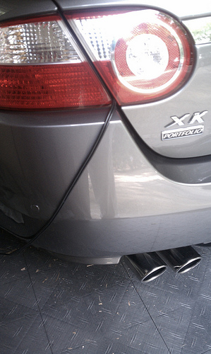

I didn't cut the spare wheel cover and simply ran the lead with the quick disconnect plug (after I connected the + and - remote charge terminals) up from under the rear of the spare wheel cover (the edge closest to the bumper). When I reinstalled the spare wheel cover I held the lead out of the spare wheel well so that lead would be on top of the cover. Less than six inches of that lead is on top of the cover and I tuck it away when not in use so it is barely visible and not in the way of anything.
I tried to explain this as clear as I could, but if it wasn't clear here's a picture of the lead with the quick disconnect plug coming out of the spare tire well and secured by the spare wheel cover; it is connected to the separate lead that goes to the charger. The little silver mark in the center is where the two leads connect:
The trunk lid completely closes over the wire with no problems.
Stuart

I have the battery charging dongle coming out of the bottom of the battery cover; not the spare tire cover.
