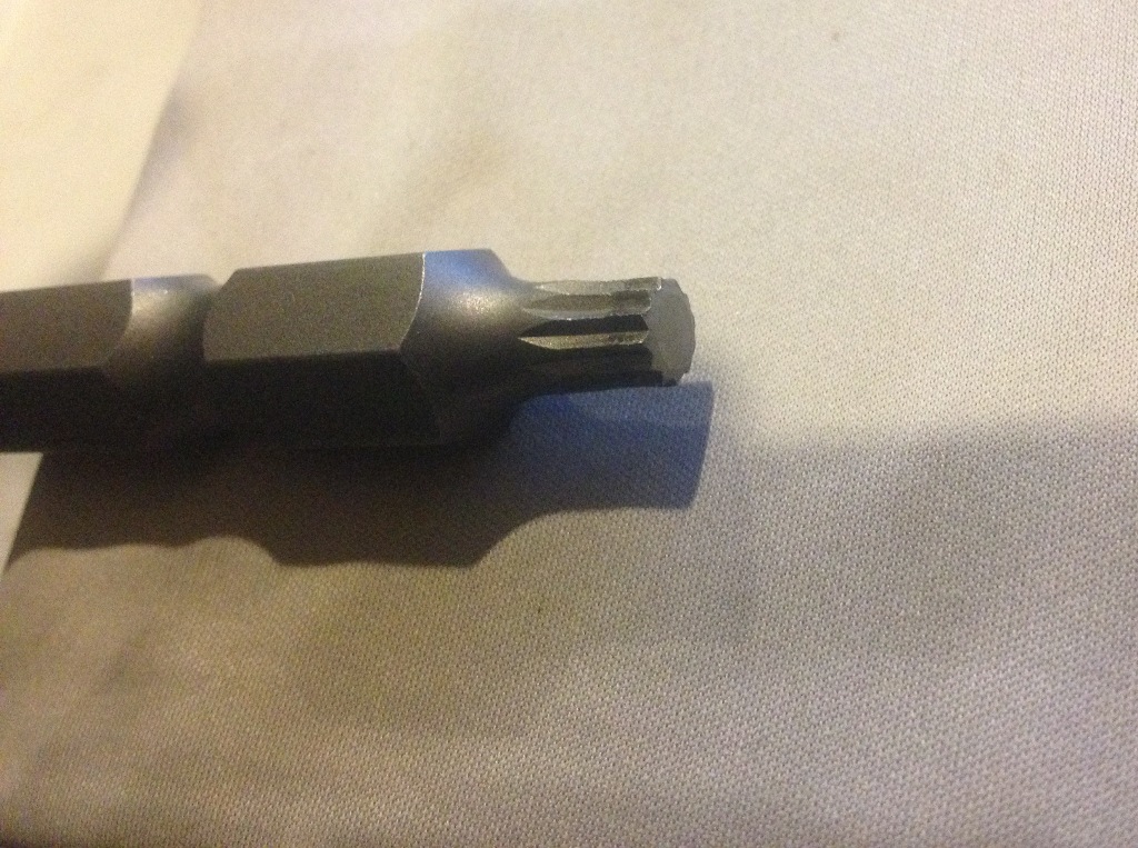

I'm trying to take these wheel bolts off my 20" Sentas so I can powder coat, Paint or plastiDip them, it seems it's a special star pattern. One forum member said they are removable.
Can anyone say for sure they have removed these before and where do you get the tool for this. Normal Torx don't work, I tried.
Thanks for the help. I'll try to post a pic.

Did you try a 12 point socket?

As Big_Walleye said you need a 12 point socket as per mine in the attached picture.
I bought a set to refurbish the Sepangs on my XJ so have just dug them out. The one that fits the bolts on my Sentas is an 8mm.
I had one of my Sentas refurbished when I bought the car because there was a scratch on it and the place that did it confirmed that they would take them all off before respraying the wheel.

Thanks sooo much guys for confirming they do come off and what size I need!!! Hopefylly I can just buy the one size somewhere. Did find the whole set on the ebay link Big sent! Thanks again!!!

I found a 11pc set of 12pt splined tool/ wrenches for $14 delivered, on Ebay

Here's the link to the tool needed
https://www.jaguarforums.com/forum/x...-favor-114101/

Picked up a set of triple square 12-point metric bits at O'Reilly today and the nuts screw right off with little effort.
