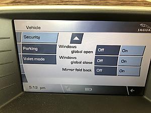

Quote:
Originally Posted by TexasTraveler
Is holding unlock to lower windows a vert thing? Tried it on my coupe and nothing...
Quote:
Both windows on my coupé open when holding unlock, regardless of whether the doors were already unlocked or not. Likewise, both close when holding locking button OR the button on the door handle. I think either closing or opening can even be interrupted by releasing the button, so that it doesn't close or open fully.Originally Posted by Cee Jay
Mine do, but missed opportunity; they don't go back UP by holding LOCK.

Quote:
You have to go down to the third screen in the Security menu to find it.
right were you said it would be... I was able to turn on the unlock window down feature but the lock window up feature goes back to off about a second after turning it on... Originally Posted by u102768
It is user configurable on my '10 XKR.You have to go down to the third screen in the Security menu to find it.

Quote:
Yes one touch with window switch works for both up and down...Originally Posted by u102768
Does your one touch up work when you use the window buttons on the door?
Got the following from another thread
Quote:
Update 2 - My S/A advised me that they are not allowed to enable the Global Close feature in the U.S. for liability reasons.
They offered the example of a child in the car getting their hand crushed by the window activated from outside the vehicle. I remarked that as far as I was aware all new cars had pressure sensing windows that would cease operation if an obstacle obstructs the window closing. I was told that the pressure sensor only works when using the window switch in the door, which I don't think is true. Even so, I would imagine that the pressure sensing feature could be enabled for operation outside the vehicle thereby absolving Jaguar of any liability.
Regardless, we have our answer, and the dealerships will not activate the feature for U.S. cars unfortunately.

Just as an update, my dealer was able to use SDD and go into the Car Configuration File (CCF) and turn on Global Window Close feature, so if you have a dealer or Indy with SDD this can be turned on easily on USA cars with a willing technician...
