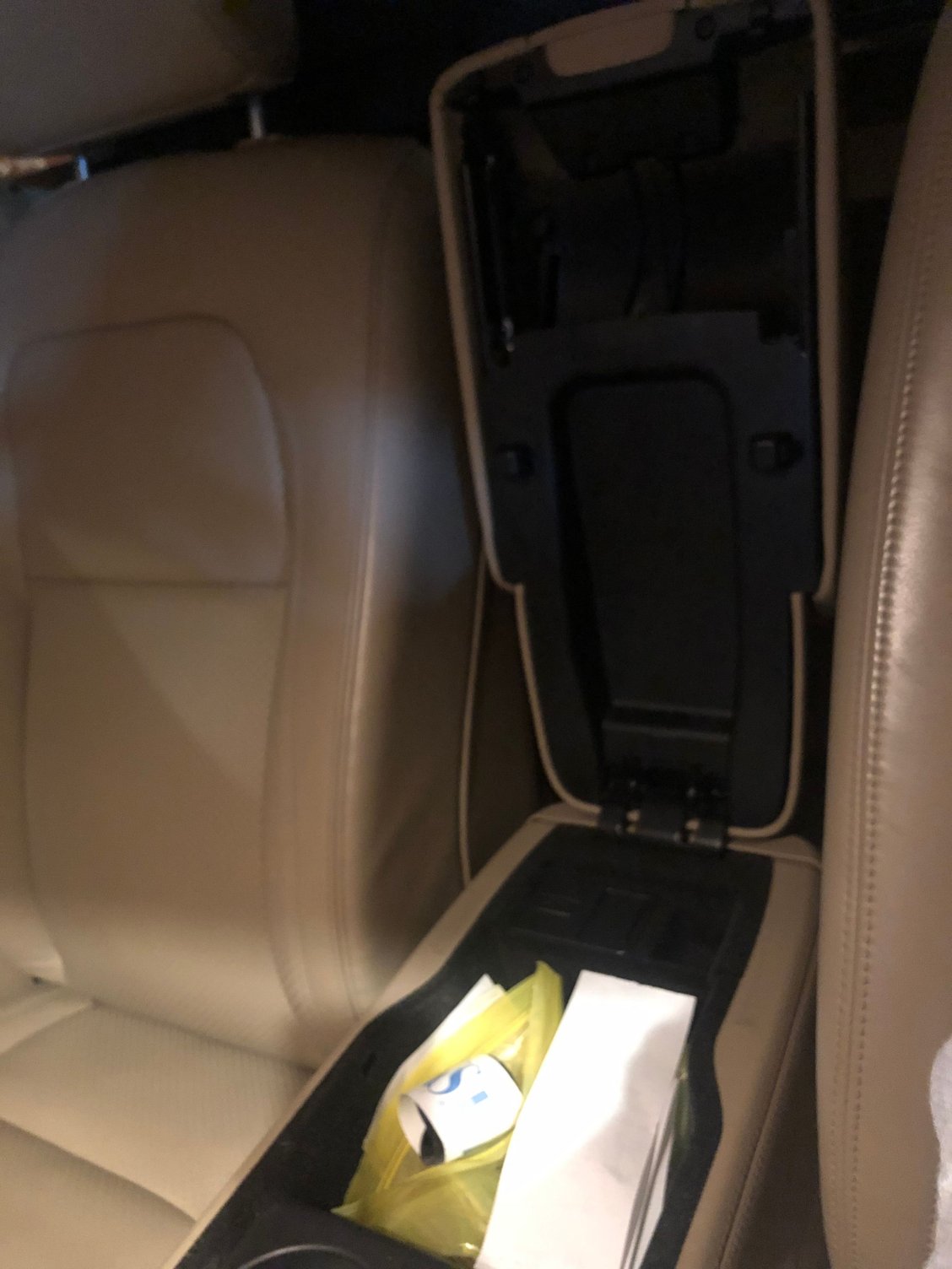

You got me curious, so I went out to the garage to check mine.
I agree with tampamark, the lift latch controls both the lift locks and slide locks at the same time, one of each on each side.
So if I pull the lift latch to release the lift locks, then release the handle and just raise the lid, it stays in the full forward position.
While its open, if I lift the handle again, it will slide backwards.
Here’s mine standing at attention (ignore the crap in the compartment):
Lid open and extended.
