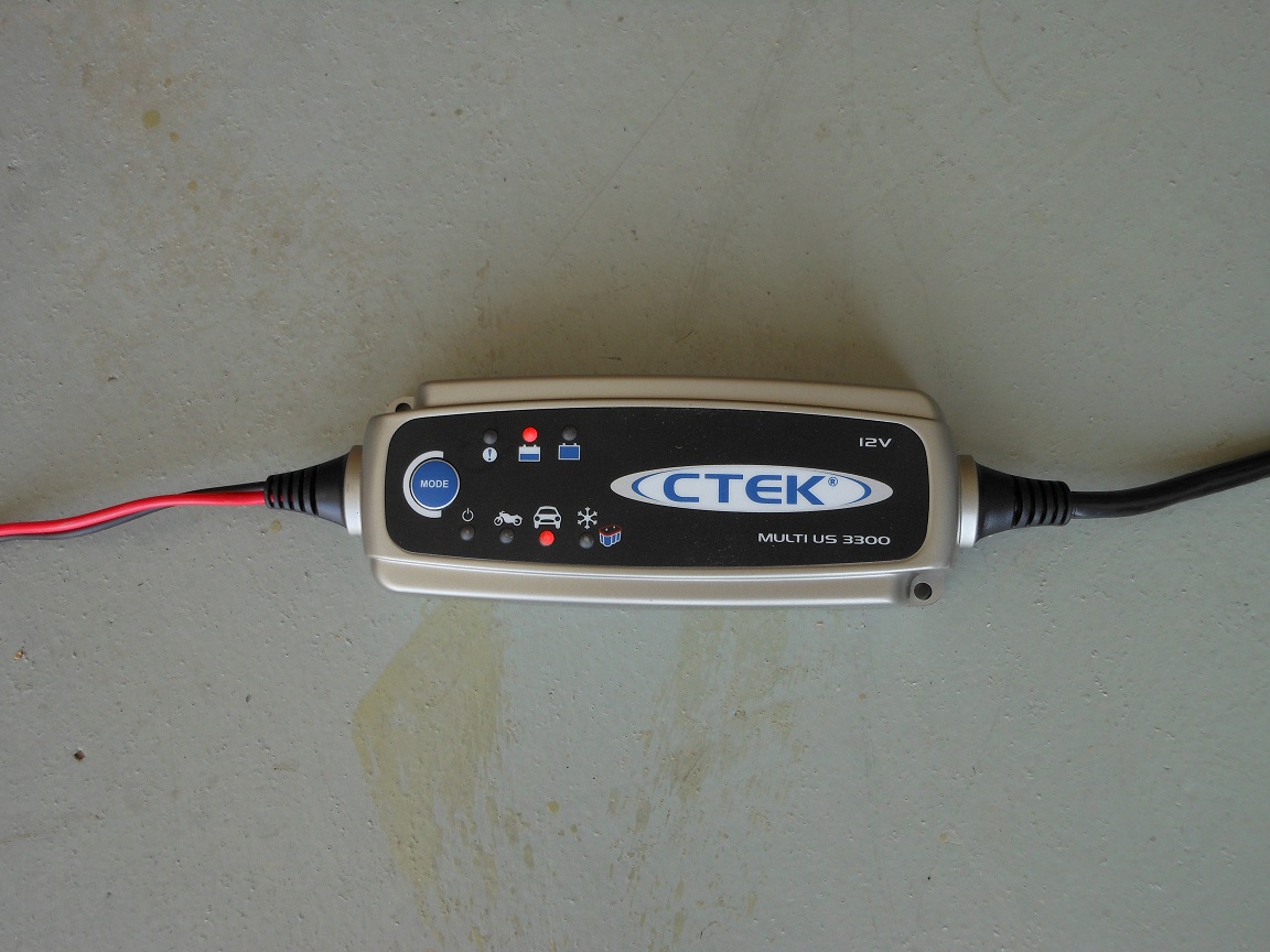

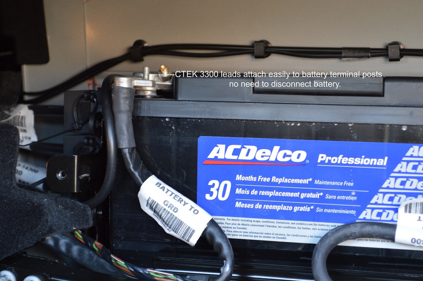

Consider buying a CTEK 3300 trickle battery charger and hook up to the Jag permanently. It will be the best $52.00 bucks you have spent on your car. No more low or dead batteries. Just unplug and go, leave wire permanently hooked to battery.
Amazon.com: CTEK Multi US 3300 12-Volt Smart Battery Charger: Automotive Amazon.com: CTEK Multi US 3300 12-Volt Smart Battery Charger: Automotive
A few photos from my hookup on 2009 XKR.
Takes 2-3 minutes to hook up leads to battery.
Excellent advice - I did the same a while ago (altho a different brand of charger).
In case the picture wasn't clear - there are threaded studs on the battery terminals that you can connect the charger leads to.
Some notes:
- Despite the Owners Manual stating 'remove the battery for charging', this is not needed - unless you do a massive 'Booster Charge' which would generate large amounts of Gas....
- (This is Important) Be sure the Charger Lead is Fused ! Since its connected directly to the battery, if it shorted - things would get ugly....
A 5A or 7.5A fuse is probably sufficient for a trickle charger. Mine puts-out 3A at the most.
And try and get an insulated or covered 12V lead
- I store the coiled-up lead under the trunk floor. As Rich's photo shows it easily passes under the trunk weatherstrip.
