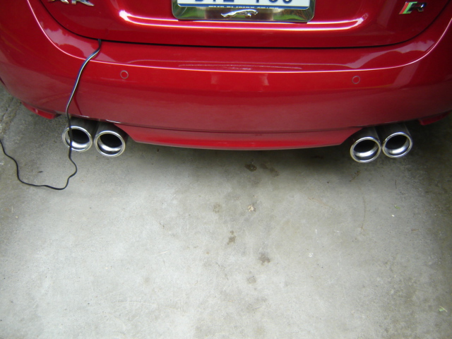

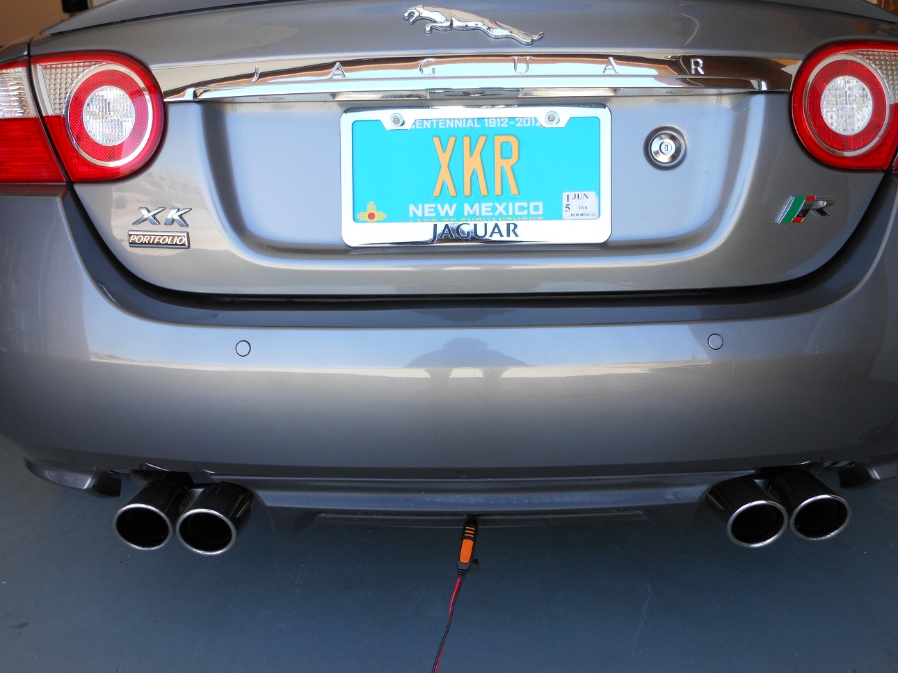

I've just got 7200 miles on the car and notice the tips getting some bluing on them. I am in the habit of wiping them down after parking the car at night but I assume they will darken with higher mileage. How are others keeping them clean and do you do anything different in cleaning them.
Also as you can see below I have the smart charger pigtail sticking out the back and I am concerned it will eventually cause wear marks in the paint. I am looking at alternate methods on bringing the wire out under the car in the rear. Anyone else done this differently.

I agree it would be a great idea to have the pigtail come out elsewhere other than the trunk, as I get concerned about opening and closing it. I hooked up my new ELM327 Scanner tool and see since the last reset of data, the car has been started 115 times, and that was 2300 miles ago. So open and closing had to be about 220+ times. No problems reported, just would rather connect the extension without having to open and close the trunk lid.

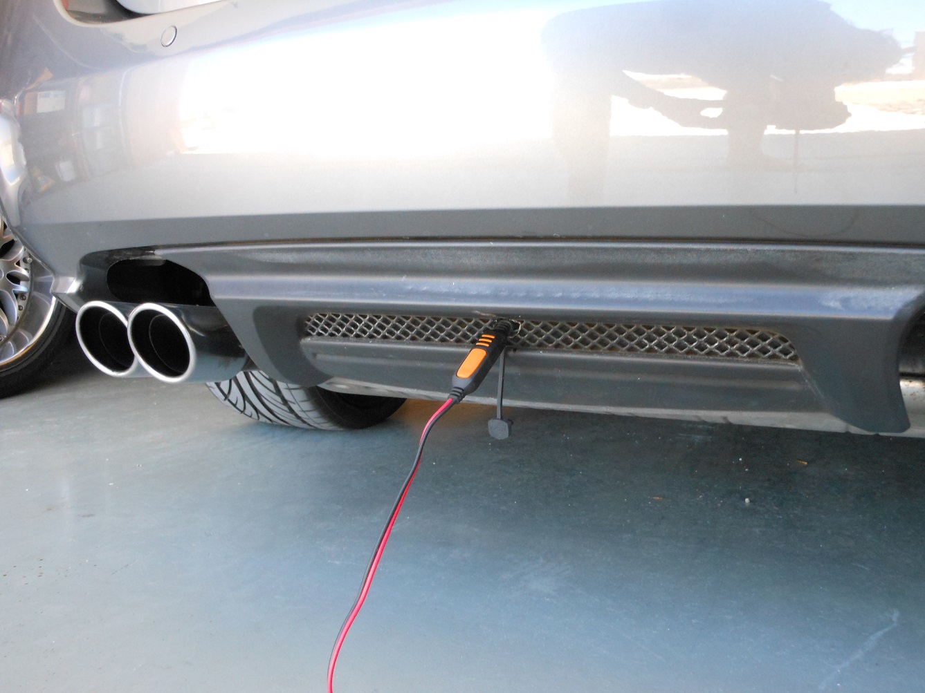

Today I looked for a way to eliminate the pigtail from my CTEK 3300 Smartcharger from hanging out thru the trunk. I was concerned about constant opening and closing the trunk, because when not driven my CTEK 3300 is always hooked up to the battery and charging. I have never had an electrical issue of any kind because I keep the CTEK on all the time. IT is just a simple plug and play connection.
I removed the spare wheel, and found that on inside of the spare wheel well, dead center, was a rubber grommet that very easy to remove. After removing the grommet, the hole provides access to the underside of the rear bumper. The ran my pigtail thru the trunk hole, and replaced the rubber grommet. Below the bumper I have a small rear type grill. I drilled a 1/4" - 3/8" hole in that grill and ran my pigtail wires thru the drilled hole, exposing the connector to the underside below the bumper and on top of the rear grill. I am not sure if your if 2012 has the lower rear grill.
I did have to cut the pigtail cord and re-splice it with quality electrical connectors. Tomorrow, I will secure the end connector so I may just plug in or unplug. I will add an additional rubber grommet to go into the drill hole. Rubber grommets at our local hardware store are .47 cents.
Now there is no concerns about the cord sticking out of the trunk, rubbing on paint (which you mentioned) and no constant opening and closing the trunk lid.
