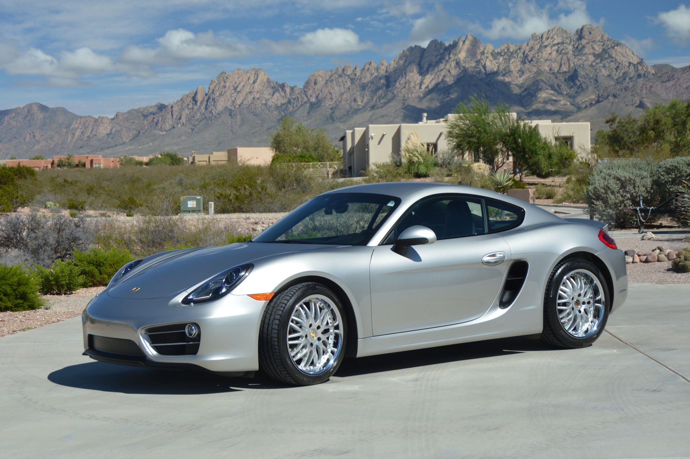

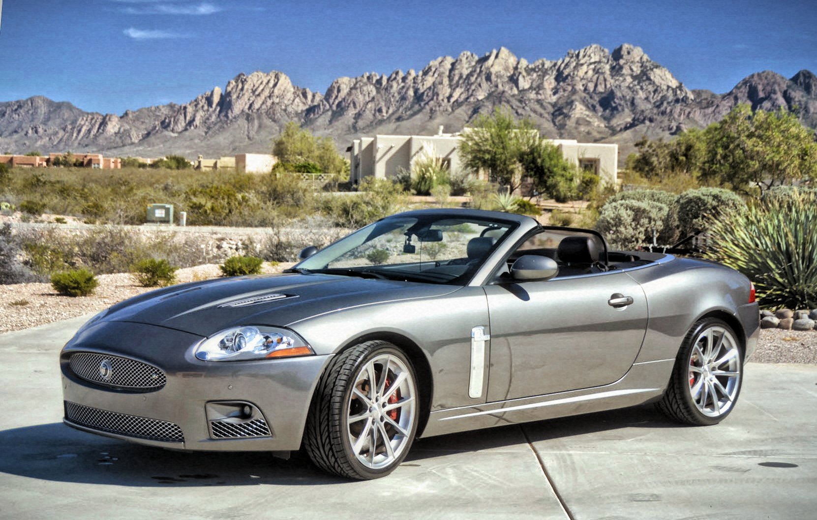

When I had my new 2015 Corvette C7 delivered after just 50 miles, I applied a nano ceramic paint coating to the paint. It is a long process of 6 to 7 hours as a DIY project. It is the proper prep work that takes the time. Then, once completed the vehicle needs to sit in a garage covered overnight for the ceramic coating to bond into the paint surface.
The project is well worth the time.
I get tons of compliments stating the C7 looks like a glass finish.
In a professional shop, and proper prep & ceramic paint coating will cost in excess of $1200 to $1500. I have seen shops charge in excess of $4000. With the proper materials and dual action buffer you can complete the DIY detail for under $150.00 and have enough materials/product left to complete 5 to 8 other cars.
I have done this on my Jaguar XKR and Porsche 981.
The results are simply fantastic and makes washing the car so simple and easy. The shine and reflective qualities are fantastic.
I also apply a ceramic coating to the glass and wheels
http://www.autogeek.net/pinnacle-paint-coating.html
http://www.autogeek.net/diamond-glass-coating.html
http://www.autogeek.net/pinnacle-wheel-coating.html
BTW, the nano ceramic paint coating will last up to 3 years. Keep in mind there is a major difference between a paint sealant and paint coating.

You're just showing off with that majestic background!!
