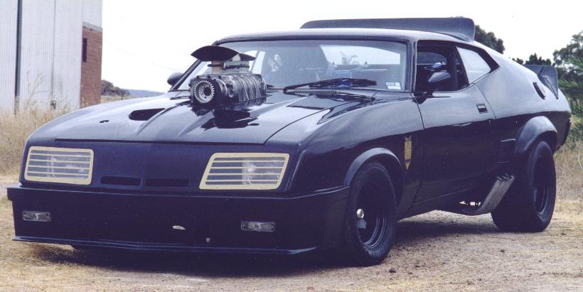

Originally Posted by MaximA
Your car sounds GREAT!
Reminds me of the Mad Max Interceptor (Ford Falcon XB GT with Weiand 6-71 blower). Here's a US replica in action:
This it what it looks like:
Attached Thumbnails Increase supercharger whine?-o3.jpg   Increase supercharger whine?-o3.jpg
