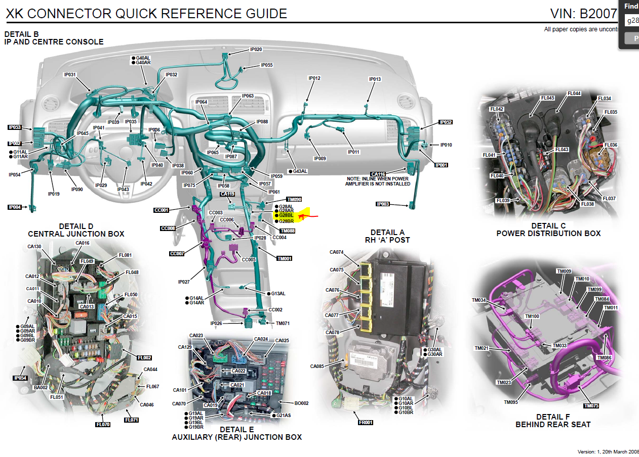

Htrd: download the appropriate electrical diagram from the Sticky. Look at the section called ground distribution. Find the ground distribution point for the touchscreen. On my '06 coupe, it's G28BL1, listed as being "beneath front console", but is highlighted in the image attached. Looks like it's near/under the ashtray. Also looks like both the ground for the touchscreen and the head unit are in the same place.
The attached is for VIN>20075, but the wiring harnesses don't change much.
Note that these images are searchable PDF's, so if you do a "find" on a connector number, it'll pop right up with a highlight.
